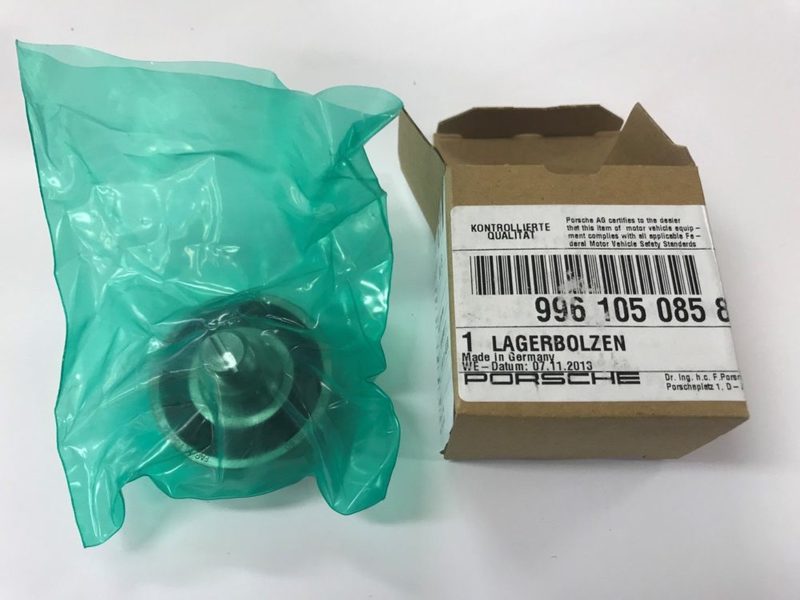

Interestingly no one is talking about the Porsche IMSB solution in this forum. Why is that?

Posts: 1,530
Originally Posted by dlud View Post
What is the cost for the Porsche "solution?"
I don't know the prices in the US. Please take the part numbers from the photos and ask your local Porsche dealer.
Over here in Germany the Porsche IMSB set is less than the comparable LN IMSB, which has to be imported – so there are customs fees, taxes and shipping that don't have to be paid for the Porsche IMSB solution.
Also we have other manucfacturers for IMSB solutions Made in Germany which are less than the LN products. So from a price point the LN products are not attractive.
