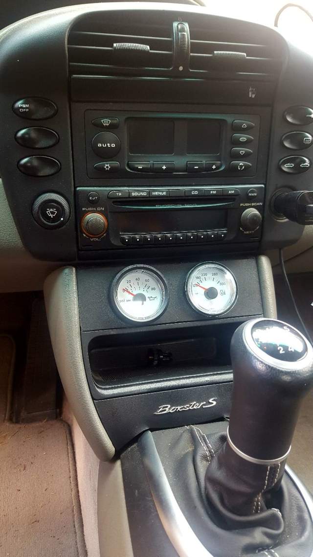

NewArt 01-10-2018 12:08 PM
I used a VDO Ivory gauge from egauges.com.
Attachment 21319
