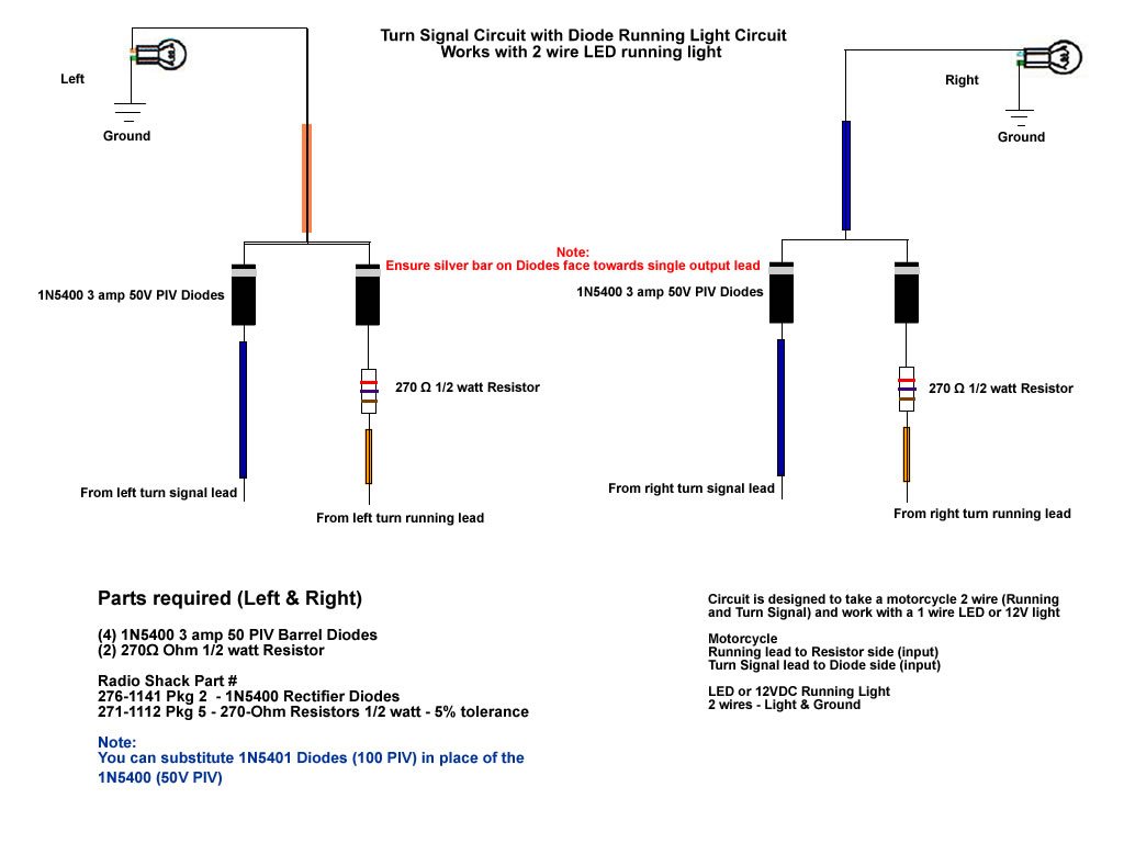

I designed a simple circuit for motorcycle two wire LED turn signals.
The same circuit would work for the side markers lights.
The circuit is nothing more than two diodes and a resistor.
Since the side marker lights are only two wires - 12V & ground this would work for what your trying to do. (side marker lights as running lights & turn signal)
You would basically feed the turn signal lead into one input (diode only lead) and the parking light lead (running light) into the other input. (diode with resistor)
The single output lead would go to the side marker light. plus the ground wire..
All the parts can be acquired from RadioShack. Simple to build, I used heat shrink tubing to enclose the components.
See drawing of the circuit below.
Your biggest challenge would be taping into the turn signal lead for each side.
You would need a total of 4 diodes and 2 resistors. RadioShack part numbers provided.
Hope this helps
T

This circuit has been installed on several motorcycles and are still functioning to date, mine included.
I've been running it for several years.
The diodes in this design work as one way switches, the PIV (Peak Inverse Voltage) rating of 50V prevents the voltage from back feeding into each input respectively. The resistor on the parking light input simply dim's the parking/running light.
If you have the fast blinking from the LED's, instead of load resistors I would simply change your Flasher relay to one that supports LED's.
EFL-3 LED Flasher Relay. Simple and doesn't require load resistors on every connection.
I'm not a proponent of putting load resistors across power leads.

Meir:
The circuit provided below will not require relays.
You can simply change the car's stock flasher relay with the model EFL-3 Flasher relay for LED's.
It plug's right in in place of the stock flasher relay. (It will handle hazards & Blinkers) (3 Pin flasher relay)
3 PIN ELECTRONIC LED FLASHER BLINKER FIX 1157 3157 7443
Circuit explanation:
The diodes act as one way switches of the voltage (out), they block the return of the voltage into the other input lead. (PIV) Peak Inverse Voltage
With a rating of 50 volts PIV, they will not allow the voltage less than 50 volts from returning. Of course the higher the PIV rating, the higher the voltage it will block. 50 volts PIV is more than enough to block 14.5 volts from the car power even at full alternator charging.
To give you an example:
The parking light is on, passing voltage out the resistor & diode to the LED or bulb, the other diode connected to the turn signal lead will NOT allow that parking light voltage to return to the turn signal input.
When the turn signal is engaged, along with the the parking light being on, it will pass the blinker voltage to the LED or bulb.
The diode on the parking light will prevent or block the blinker voltage from returning into the parking light input.
To summarize, they both will pass voltage to the LED or bulb, but block the return of voltage to either of the inputs.
The resistor's role in the parking light is to dim the parking light output, thus when the blinker is engaged, it will illuminate brighter than the parking light.
hope that explains it a little better..
T

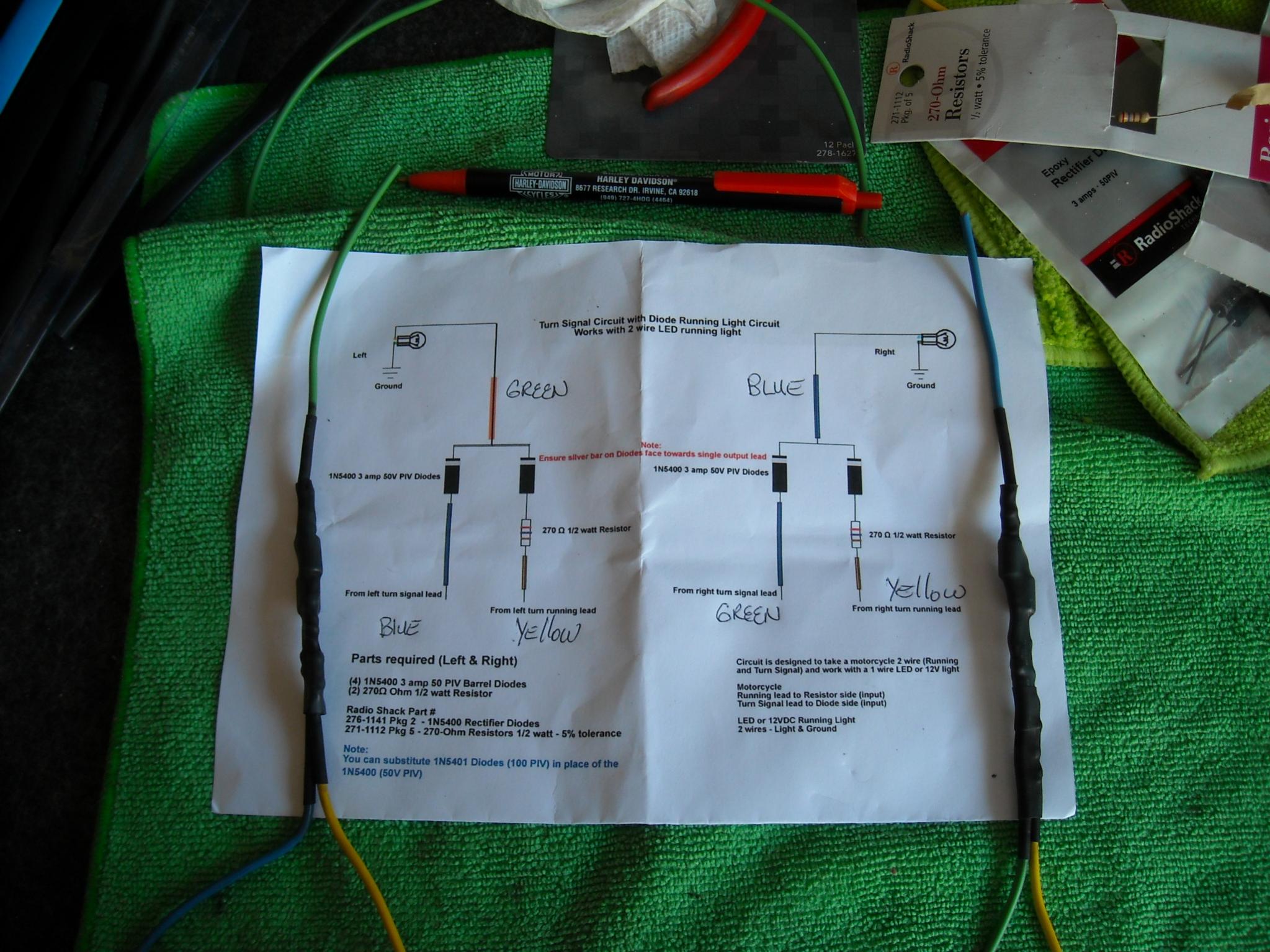

Here's a picture of the components assembled with heat shrink tubing for insulating.
I basically soldered the wires to the ends of the components to allow for connection to the wires on the vehicle.
Attachment 16714

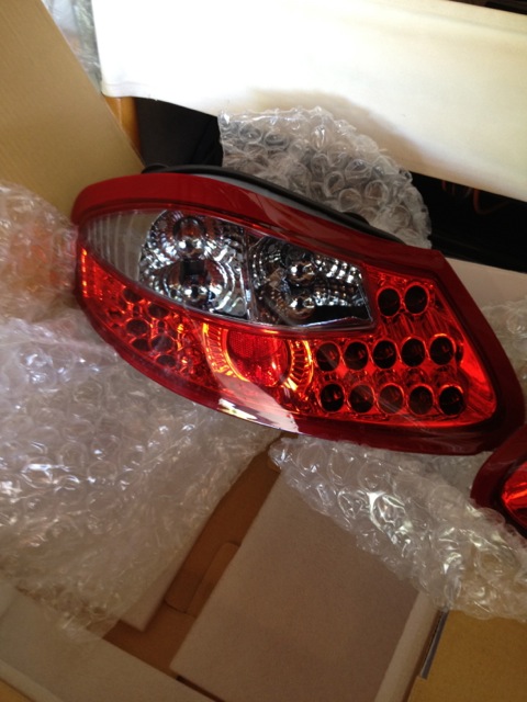

The model DEPO rear lights were designed with light bulbs for turn signals and reverse lights, the front headlights have LED's built in. White LED's that flash amber when engaged. I'm not certain if the LED circuitry has built in load resistors. But the combination of the front and rears do not cause the hyper flash. I also change the 3rd brake light with a LED model and it didn't need load resistors. Had no ill effects that some members encountered with the cruise control not engaging that I read.
T
Attachment 16719Attachment 16720
