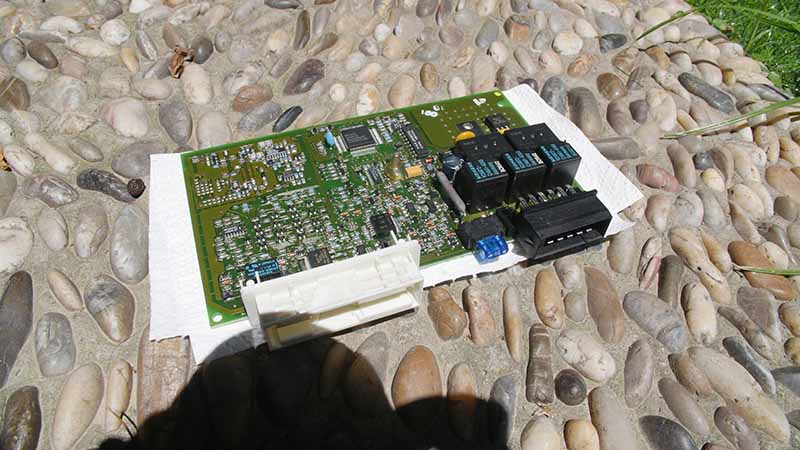

Immob was covered with condensation droplets between the flooring sheet metal and enclosure. Unfortunately I've brushed off the thick white powder/corrosion (oxi, whatever) it had around the pins/solder before snapping the pics so it doesn't look that bad on the pics below, but it was devastating to see folks. You can clearly see some pretty ugly damage on the last pic
Now what, read $3k for that made in Philippine pcb, and I-Dont-Have-$3k L0l0L

Drying it using special tooling right now; my wife's hair dryer. I'll brush off as much as I can but me don't think this will do anything (see white spots everywhere on the 20/y/old pcb). Lost hope of the day, pissed, depressed, and suicidal. there
Do I need to reflow some of the rusted 'welding' on this thing with fresh solder? how does corrosion affect components, especially the pins which seems to rust quite easily on this board. Does/can the pin occasionally detach from the solder?

The data that is specific to your car is on a single ic. From what I understand it is not reprogrammable in the immobilizer (not eeprom). Rather, the DME can be programmed to it. What Q does is de-solder and transfer that little piece of magic from one immobilizer unit to another.
Sure that the great-and-powerful Nine8Six can do it selfie. Just opening a box I only see 2 ic's of interest and I already know it isn't the bigger of the two.
Not the case...the EEPROM is read/write. This is personal experience, not speculation. Certain people that repair these immobilizers at a rate of hundred$ for 10 minutes of work don't want the average Joe to know how simple it is.
As I stated, I just walked someone through the process via text message. It is very simple. His car is now running great and all immobilizer functions are back to normal.
{part# removed}...exact # varies by model.

'97 for your reference/record below Charles. And can you please source/fabricate us a sealed enclosure that the Immob fits into? (please). You'll save so many great Boxsters and 911... these things are nearly shot man, or soon will be if not taken care right away. Take my word... not exactly cheap :/
^ Look at that corrosion build up... 20 years (or possibly 22 years, not sure loll)
