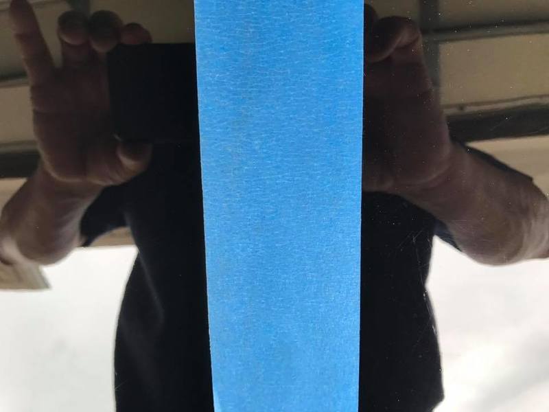

Here's a reflection pic I took after doing a 4-step polish on my 911 cab:
