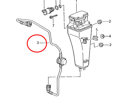

QUESTION: Has anyone needed to replace vent line 996 201 255 07 (#3 below)? If so, what were the symptoms?
