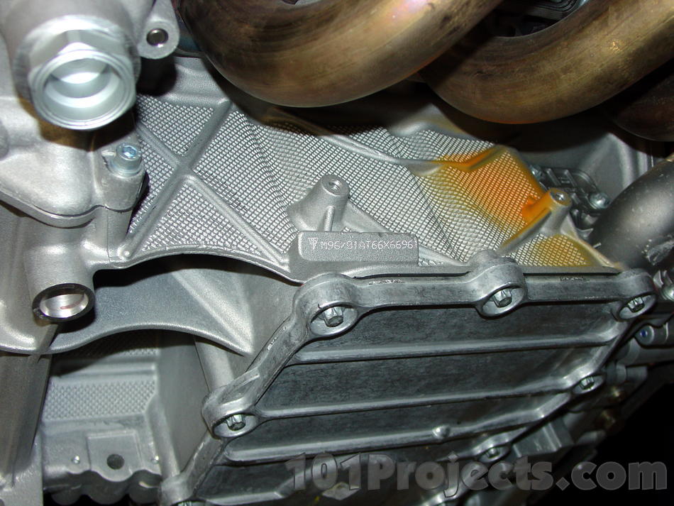

This is how it should look like on an AT engine:
Regards, Markus

as the AT number on the engine says, the pitures shows a replacement engine (Austauschmotor).
My problem wasn't the dirt on DaveBBOXSTER engine number. It was how it was punched in the aluminium and that some numbers / digits aren't readable or not there. These numbers digits where originally made with a computerized robot. And that looks different, even if there is dirt and some kind of corrosion.
Regards, Markus

if the numbers don't match, the engine doesn't belong to the car. If the engine was rebuilt by Porsche it has to have the digits AT in the serial number, which this engine obviously doesn't have.
Engines that were rebuilt by Porsche at this time don't have handpunched serial numbers. In general they have used new engine blocks for the rebuilds, because of the coating problems of the cylinder walls.
