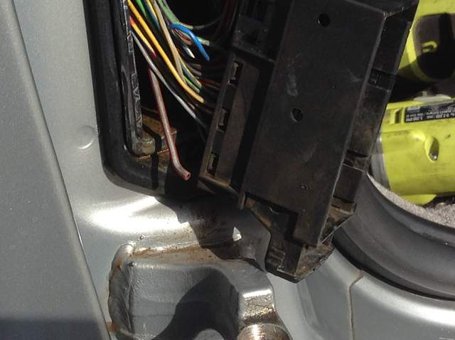

I have replaced both window regulators in the last few months and figured I was done with windows. Apparently not. My driver side window quit working on Thursday and game on. I thought maybe motor, maybe switch, if I am lucky.
So I tore into it this morning and started checking and swapping parts back and forth between the working passenger side. Every combination works on the passenger side. Next step lunch and a nap.
I get on the forum and start searching. Window and motor bring up a massive amount of links. I was finally able to narrow the search down to a handful of listings and start reading. Half way through, I find a link from +/-2006 addressing the "know condition" of the leaky plug cover between the door and the A pillar. Who knew. I pulled the cover off and it was half full with rusty water. What a mess. It had corroded one of the lower wires on both side of the connector and they had broken off of the pins. Problem found.
I can't thank the forum enough for all of their help and support. Without this resource, I am not sure I would have ever found this problem or solution on my own. I can't imagine what this would have cost at the dealer or indy.
I soldered a jumper between the two wires. Problem solved. I am not going to replace both harnesses and pull the dash board out for one wire. I blew all of the water out with air and washed it out with contact cleaner. Everything is back together and working correctly. I checked the passenger side and it was dry as a bone.
I have included 3 pictures for clarification;

Yes, thank you very much. In your case was the issue of the corroded wire, the *red/white* wire in your pictures? Anyhow, I'll go am check mine!

Correct, that wire was corroded and had separated from both the male and female pins in the connectors. All of the lower wires show signs of corrosion, but that one was the only failure so far. I gave the rest of them gentle tugs and all appeared to be sound. Time will tell.
