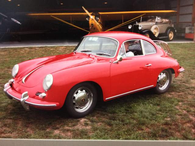

Originally Posted by rexcramer View Post
Please post pic's of the 356's, when you have a chance.
My main hobby cars:
1965 356C coupe (guards red)
1964 356C coupe (GMC ultra-silver, lead car on left)
David Wildrick is offline   Reply With Quote

Nice. Is that J-3 yours too?
flaps10 is offline   Reply With Quote
Old 03-08-2016, 03:05 PM   #13
Join Date: Sep 2005
Location: Houston, TX
Posts: 28
Nope, the shot of the red car was taken in 2008 at the Porsche 356 Registry East Coast Holiday held near Lancaster, PA, at an antique plane air strip in 2008--thus, the vintage airplanes (J3, etc.) and car in the background. While we lined up our cars for the people's choice concours, they were giving rides to the crowd in a crop duster biplane until some heavy rain set in.
