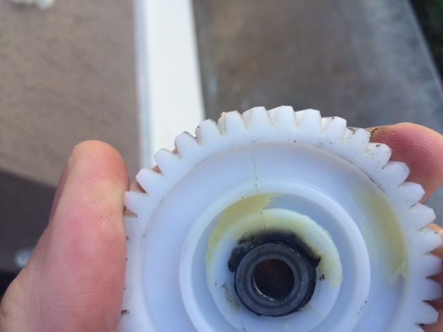

On inspection I had one stock right transmission ( part # 986.561.180.01 but with a metal drive gear shown below (is that stock for 98 ?)
And a newer left one (part # 986.561.179.03)
that seems to have an electronic switch on it.

4. The newer transmissions as shown above , are they more reliable? Mine has a crack in the drive assist gear that I will need to to replace.
Crack at 12:00
