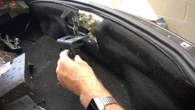

Here's the latch mechanism on my 01 parts car:
It unlatches by moving the lever to the direction of the red arrow. If you are willing to take an invasive approach, you may be able to drill through from the center-back of the trunk and insert a tool to push on it.

Originally Posted by DMage
Maybe a good time to upgrade to DEPO tail lights? If I was in the situation I'd dremel them apart and go in through the tail light opening,
Brilliant! With the left tail removed I can easily reach the latch assembly. If the plastic cover is still on, it will be held in place by the closed lid and two phillips screws. It is probably easier to destroy the plastic cover than the metal parts of the trunk. I have a spare 01 base tail and latch and I expect Woody has a few laying around cheap.
