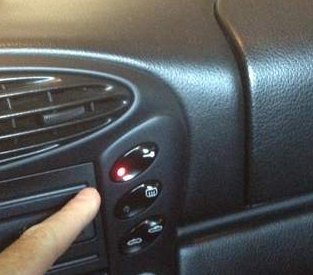

Occasionally (and getting more frequent), the Lock button LED will be lit in the interior of my car. When that happens, the auto drop on my passenger window does not work and the car will beep twice when I unlock it. The driver door seems to work fine.
If I go for a drive, put the window down or open and close the passenger door, it sometimes goes out and then the window works normally and there is no beep beep.
I would like to fix this problem given that the frequency is increasing but want to check and see if there is someone who believes that it is a different problem.
