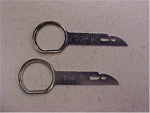

I would pull the radio (very easy with the below tools) and check the rear connectors. It is rare that amps just die like that. Also, plug in a CD (or cassette) and see if that portion works.
