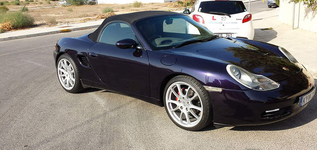

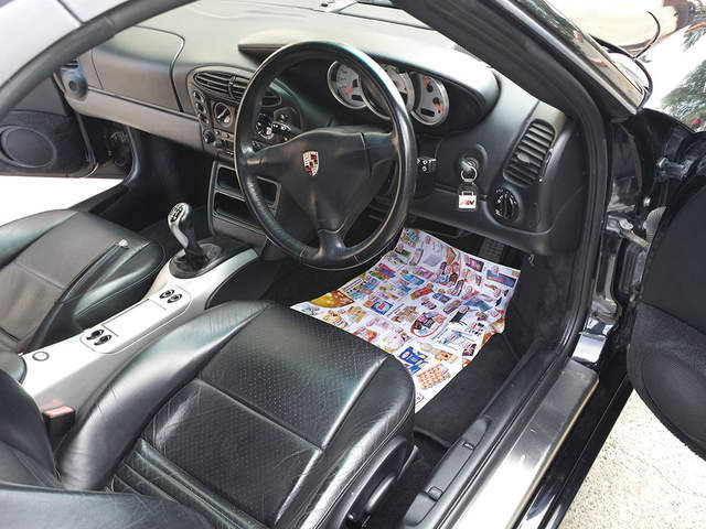

the 2.7 has under 100k km and the 2.5 has around 120k km......
the first two photos is the 2.7 ( the black has 18 inch rims) and the last two photos ( the purple? 2.5....has19 inch rims)

The black 2.7 - later (better?) larger engine, 3 spoke steering wheel, S/S door entrance kick plates, silver centre console & less km. But no A/C, how much would one cost to be fitted by a specialist A/C installer?
The purple car is a hotch potch of colours, red seats (they look like add on sports seats), grey and black interior, 19" wheels look ?? - no thanks.

The '99 is kinda ugly in those colors, but the sport seats are really nice to have and a very expensive option. I paid a small fortune for mine from a dismantler.
the shift knob, headlights, and side markers have been upgraded in the 99 as well, and of course those aren't the original wheels.
Although I like the looks of the black car better, I'm still thinking the 99 is the better choice. No AC would be a total deal breaker for me.

I don't like the interior color combination of the 99. That red and grey just don't like to be in the same car together, but those are actually very nice seats. I'd probably trade the seats for ones that match better.

The white gauges and silver console on the black car are classy. Purple cars interior hurts my eyes.
