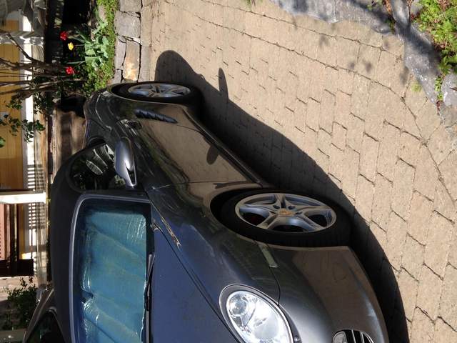

Hopefully I will be able to load the pictures, I installed H&R 15mm R and 10mm F spacers:

Thanks Gilles those photos are very helpful. Beautiful car by the way...I think the Cayman is one of the best looking designs on the road these days!
