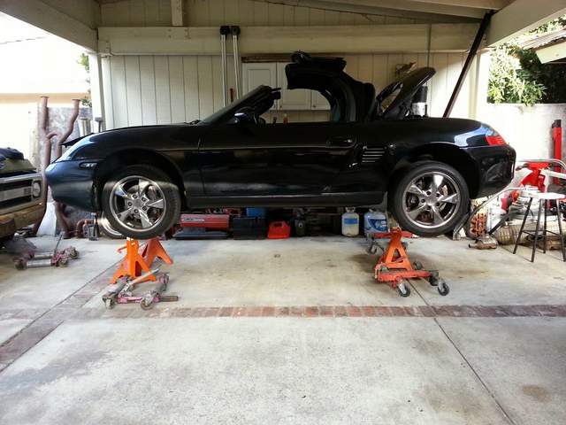

Esco jack stands have a flat top. I have had mine way up high on those and it's very stable....its the trip up thats dicey

healthservices 04-19-2015 06:03 PM
Originally Posted by stephen wilson (Post 444214)
Originally Posted by healthservices (Post 444210)
If you set the jack stands correctly you can set and forget. I had these under my mustang for over 10 years and numerous earth quakes.
Knock on wood nothing has ever happened
http://986forum.com/forums/uploads01...1428594278.jpg
Gack ! ... you're Mustang has become a storage shelf, just like my '65 project !
I finally sold that a couple years ago and put this on it for a while...
http://986forum.com/forums/uploads01...1429491739.jpg
Then this...
http://986forum.com/forums/uploads01...1429491387.jpg
scary how high it looks. :eek:
