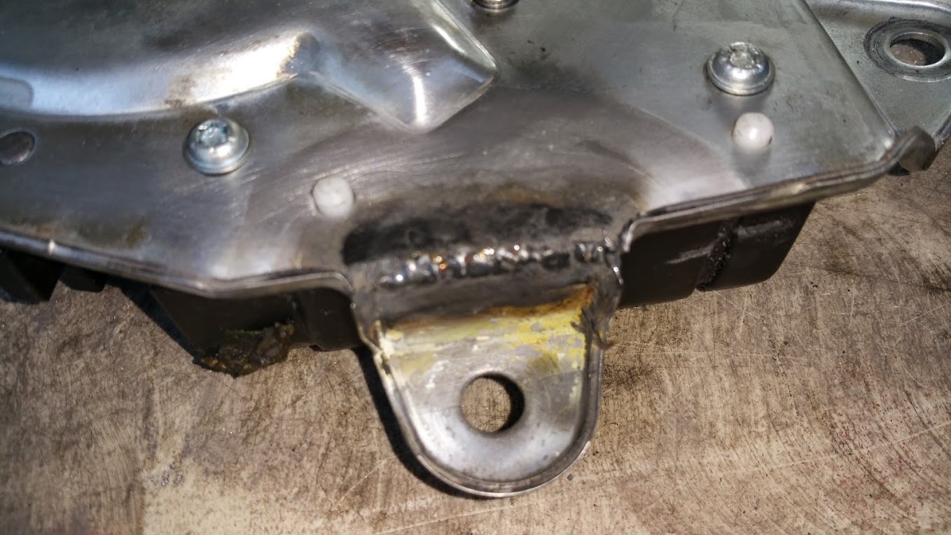

Cracked it open...
Surprisingly it's okay
Although I will still need to fix or procure a new cover as this one has a broken tab..

eh got lazy as I have too many cars to work on at the moment. Just used a stack of washers and a bolt to reassemble. I should have used a stud instead but this was what was in the bolt drawer. I also just welded the broken tab back on... Sorry for the out of focus picture.
