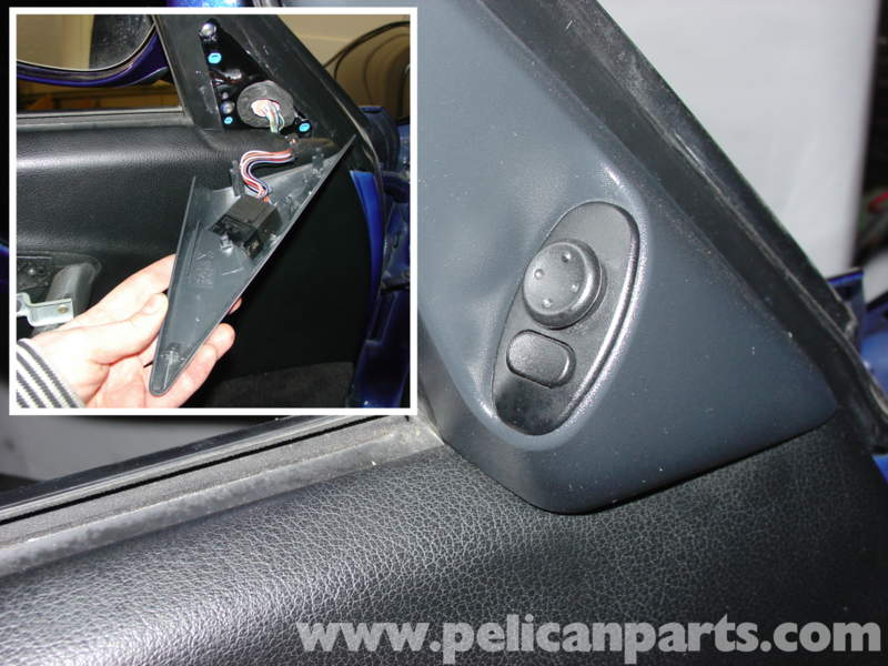

Triangular Trim Piece Clips
The triangular trim piece in the leading edge of the window frame on my driver side has some missing/broken blue clips that attach to holes in the door and hold the piece in place. I noticed it was loose when I was cleaning the interior. I tried searching pelican parts and eBay etc...but can't seem to find replacement pieces to pop in there.
Does anyone know where I can find some? If not I'll try to figure out some other way to secure it and still have the ability to remove it.
They are the three bright blue pieces in the top left image.

I think it is P/N 191 853 615 A which is a VW part number. Do a Google search for that P/N and there are several images that appear to be for the blue grommets.
