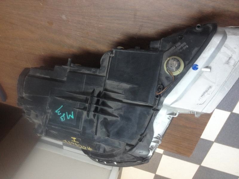

I bought a set of used litronics that I knew were not in very good shape. My plan is to refurbish them if possible and install them on my 2000 Boxster.

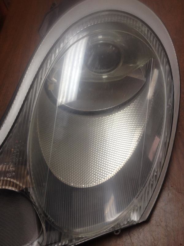

The passenger-side headlight appears to be in decent shape. I'm planning to use the Sylvania headlight restoration kit on it to take the discoloration off the outside of the lens and just clean it up. I'll check to be sure it works before I expend the elbow grease. Here are some pictures:
http://986forum.com/forums/uploads01...1415247611.jpg
http://986forum.com/forums/uploads01...1415247714.jpg
You can see the oxidation at the top of the lens here:
http://986forum.com/forums/uploads01...1415247863.jpg

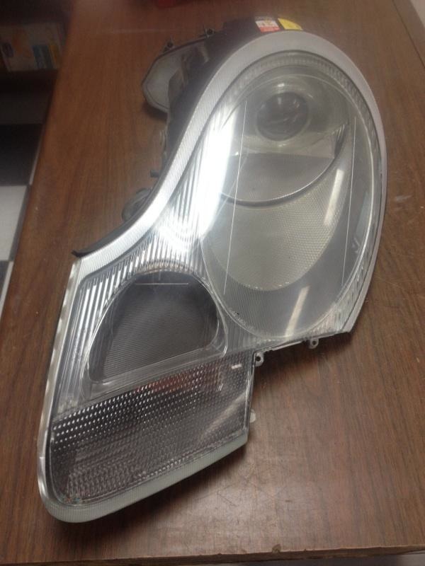

The driver-side headlight is a little rougher. The lens needs more restoration than the passenger lens:
http://986forum.com/forums/uploads01...1415248034.jpg
The more significant problem is that the back side is broken and many of the internal components are rattling around loose. The litronic bulb (D2S) is broken and the reflector behind it just slides around:
http://986forum.com/forums/uploads01...1415248157.jpg
Does anyone have experience with repairing the internal components of a litronic headlight? Can you suggest how to fix this? For example, should I consider heating the unit and removing the lens so that I can work inside the bucket? Can I use the bucket from a non-litronic lens and fit the litronic components inside.
Would it be better for me to find another driver-side lens and just use the components in this one for spares?
If anyone has a litronic with a broke lens to sell and everything else is intact, I'd be interested.

KevinH1990 11-08-2014 08:22 AM
5 Attachment(s)
Right now, I don't have the option of swapping a very clear non-amber lens onto the litronic since I don't have one.
I may polish the drivers-side lens that I have before I tackle the passenger side. The driver's side light that I have coming from the salvage yard looks pretty good. Here are some pictures that they sent me:
Attachment 18935
Attachment 18933
Attachment 18932
Attachment 18934
Attachment 18931
If the polishing process doesn't work well on the driver's side lens that I don't need, I'll probably decide to live with the discoloration on the passenger-side lens.

My driver's side headlight arrived yesterday. Unfortunately, the wiring inside is a mess. You can see all of the electrical tape wrapped around the wiring. There is a lot of missing insulation and broken wires. I negotiated a price reduction with the salvage yard that sold it to me.
http://986forum.com/forums/uploads01...1416017003.jpg
Fortunately, the wiring in my broken driver's side litronic is in good shape:
http://986forum.com/forums/uploads01...1416017064.jpg
I'm planning to transplant my good wiring from the broken headlight into the unbroken headlight with the bad wiring. It all looks pretty straightforward except for the wiring for the foglight and the turn signal. The turn signal looks particularly difficult since the wire runs the length of the headlight assembly and it will be difficult to get in there.
Does anybody have a suggestion for doing this? For example, could I gain access by removing the clear plastic cover? Or should I cut a small hole in the bucket near the connector for the turn signal.

I had a busy weekend and I only had a few hours on Sunday afternoon to work on the lights. I used the Sylvania restoration kit on the good working headlight. It did a great job taking off the oxidation on the outside of the lens.
Before:
http://986forum.com/forums/uploads01...1416274035.jpg
http://986forum.com/forums/uploads01...1416274524.jpg
After:
http://986forum.com/forums/uploads01...1416274075.jpg
http://986forum.com/forums/uploads01...1416274120.jpg
I think that I may do it again in a year or two. I thought I had sanded very thoroughly, but I think there were some areas where I did not remove all of the factory coating on the headlight and I can see some imperfections in those areas. It is particularly noticeable near the turn signal. However, from about 5 feet it looks like new.

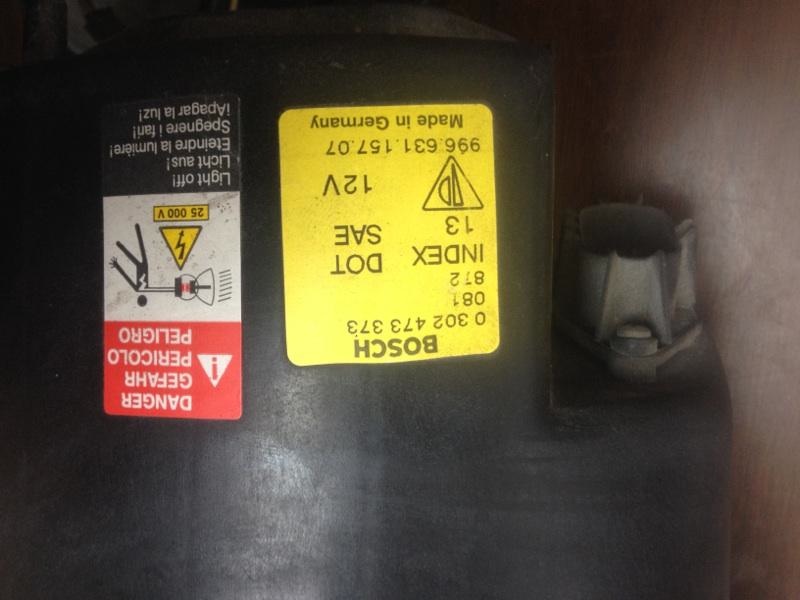

I ran into a few issues, so my project still isn't complete. One of the headlight ballasts (the one from the broken headlight) had water in it. I opened it up and rinsed it with distilled water and then dried it out. However, it wouldn't work so I bought a replacement on ebay for $40. That arrived yesterday and it worked fine.
Also, when I tested the lights, none of the parking light bulbs worked. The litronic headlights use a different bulb (H6W) then the non-litronics and I couldn't find them in a couple of local auto parts stores that I checked. So, I ordered a pair from Rockauto and they are scheduled to arrive tomorrow.
