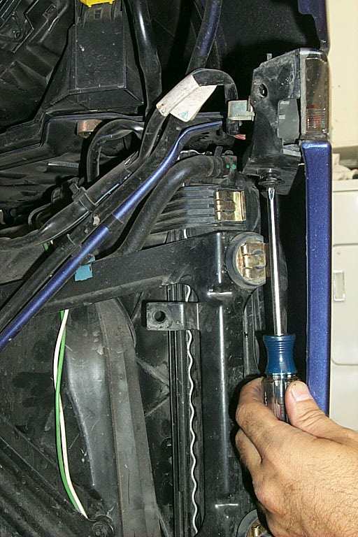

All 4 by the sidemarkers?
These are the two (one each side) most people overlook:
full instructions here: http://www.skylersrants.com/Porsche/Radiator/Radiator.html
full instructions here: Accessing the Radiators
Thanks.Removed and cleaned this afternoon
