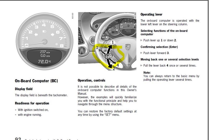

If you have the OBC, there's a wand on the left side, lower one. (US) you push it forward to access categories, pull back to select, (or vice versa), and up / down to scroll through options.
You basically customize the display lines. I have outdoor temperature, trip, and average mileage displayed.
that's the thing. if I press left or right on any nothing is showed, only if I hold press the time one it switches from km to miles and vice versa, and I can set the time, and reset the KM driven, I cannot find temp or any other option.

how is it possible I don't have this lever?
does this mean I cannot control anything?

You need to buy the lever , a small vw harness , them get it activated .
There are obc threads on here I think , and a tech article on installing it on pelican parts website
