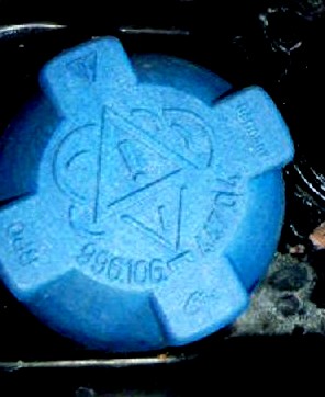

Hi guys,
I think it's time for me to replace my coolant cap. The question I have is that I've heard about an updated cap, is that cap the one that is being sold right now on Pelican Parts for our 986's, or it's a cap from a newer gen of Boxster?

I ordered mine off pelican for my 03 and the numbers ended in 04 I believe

Didn't really understand what you meant, but I did some more research and now I do. So I guess the answer to the question is the part number should end with 04 and not 00 or 01.

The new cap will look like this.
