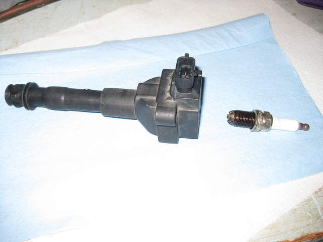

Here are pics for a 04 3.2L. If your asking how to do it its probably a good time to buy the pelican or bentley book. I have both and I find they compliment each other. They are a great confidence builder to do more.
coil and plug
coil and plug
Thanx alot for ur photo mate !!! What did u do to ur engine that requires u to take the whole thing out?

The engine's IMS bearing failed and metal was found in the oil, oil filter and oil pan. With so much metal in the engine and a failed IMS bearing the engine had to be replaced or try to rebuild. I choose the Rebuild the engine path.
