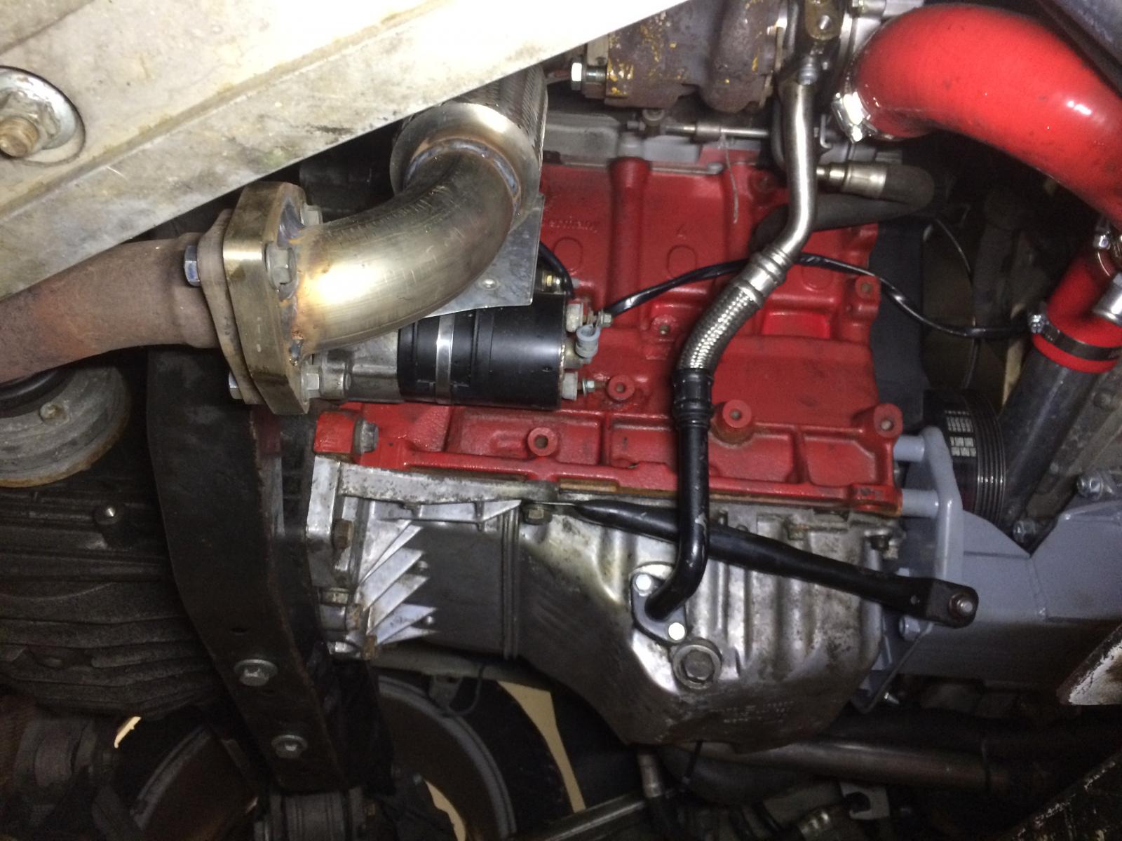

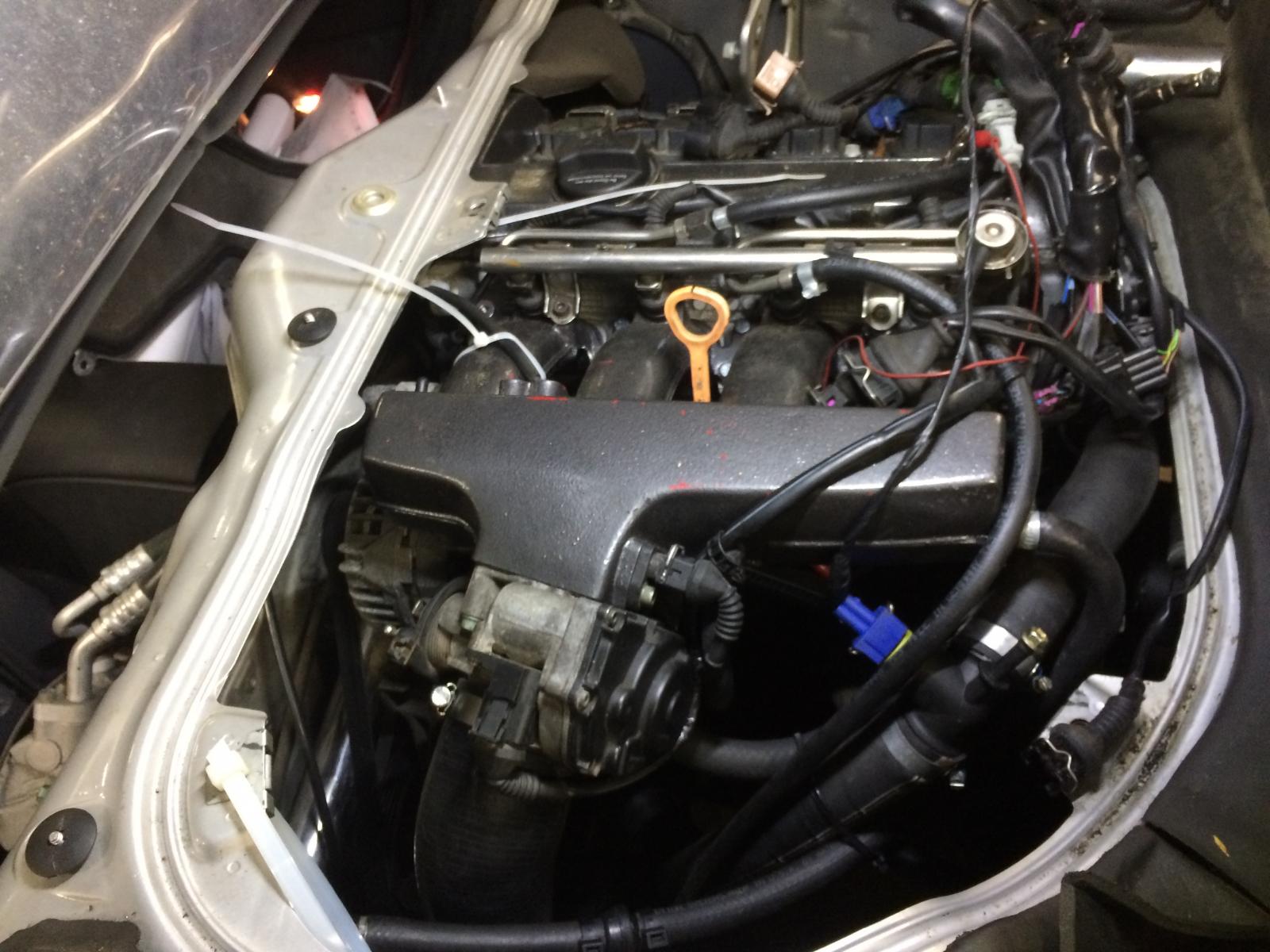

Off topic , but here are some pics of one I built a couple of years ago .

Ian c, that is beautiful.
