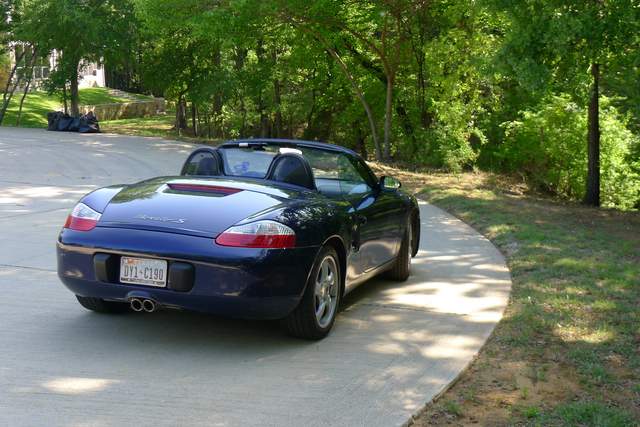

Absolutely love mine! Updates the look of the car and the LED's are very bright.
2001 Boxster S Lapis Blue
iPad Mini Dash Install
DEPO Tail Lights
