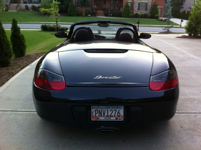

I don't get the above comment....?
These lights are beautiful and a perfect way to update the look of an older Boxster. At $100 new, I can't see how you can go wrong.
Attachment 17453

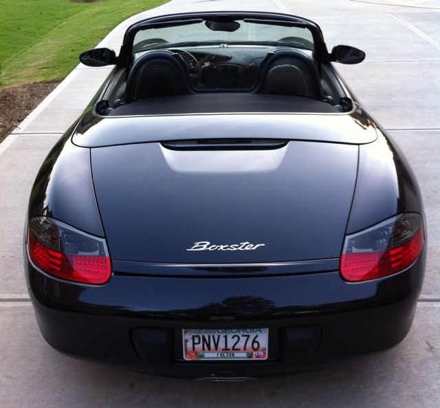

Here's another angle up with the smoked 3rd brake light:
Attachment 17459

Jeff... Looks great

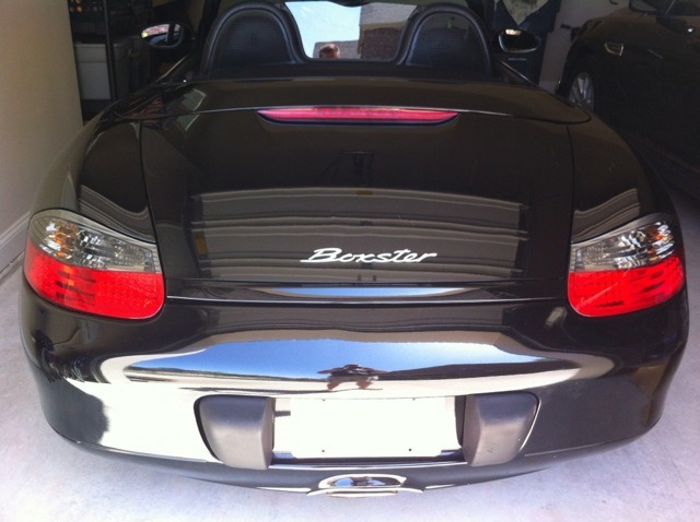

These, combined with the LED headlamps, really takes a few decades off the car. I originally bought the taillights with the clear turn signal, but I couldn't pass up the deal when the smoked were on closeout for 100 bucks. I still like the clear, so I may hold on to them and change them out seasonally.
With the clear:
Attachment 17488
ccjazz 06-19-2013 03:35 PM
I like the clear also, but on a dark color like yours the smoked lets the profile of the fenders flow more smoothly (to me anyway).
