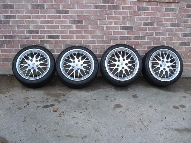

Wheels were delivered today with no problems. They shipped the same day that I paid so I would have to say they are an excellent seller.
The wheels look great with just a few noticeable marks on the polished rims. The paint on one is a bit worn but not overly so. They actually look better in person than what I thought they would based on the pictures. Some day I will probably splurge and have them refinished but for now I am very pleased. Now to order some tires!

Looks like the wheels will have to go back. I had the Michellins mounted the other day but two of the rims were bent. One front and one rear. You can only see it when the wheels are spinning. to the naked eye, the rims look fine. So I had Discount Tire take the tires off and I called LA Dismanteler. They thought they might have two replacements but I heard back from them yesterday day that they don't. So, they are refunding my money and now they will be shipped back. I have to say that LAD was very good through out this. They have apologized several times. They guarantee their wheels which is why I felt comfortable dealing with them. Buying used wheels from a private seller would be a big risk IMO. So it is disappointing but oh well, no big deal.
Discount Tire was also great. I have bought tires from them many times and they have been very good to me. They didn't charge me anything for the mount and dismount even though I tried to give them something for their time and effort.

Bummer! During my search for 03-04 Boxster "CarreraII liteweight" 18 X 9" wheels I bought bent wheels twice on E-bay & returned them. Anytime you are introducing a unknown wheel to your car put it on a wheel balancer & spin it up so you can observe how true it is & how much weight is needed to balance it. This avoids issues later & yes this applies to new wheels also.

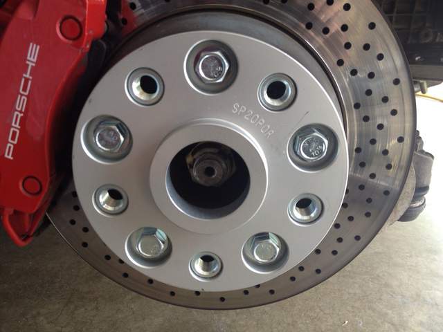

Ok, I am going to try this again I won an auction for a set of BBS Sport Classic II Wheels Rims 18in OEM (7.5 x 18 ET50) & (10 x 18 ET65). The fronts will be fine without a spacer but the rears are going to need around a 20mm spacer, correct? Anyone have this set up? And any opinions on where to get my spacers? ie, good quality at a reasonable price?

Yes I did, and I love them! I bought 20mm spacers from Wheel Dynamics
They come with short bolts to mount to the hub and then you use your original bolts to mount the wheel.

Note to Discount Tire Users:
I took the Boxster in and they informed me they couldn't touch my wheels because I had spacers on my car.
So back home I went to remove them and put them in my DD and bring them back to be worked on

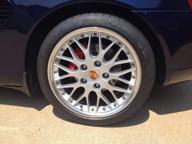

I have Michelin Pilot Super Sports 225/40ZR18XL 92Y B on the front and 265/35ZR18XL 97Y B on the rears. I really like the 903's and the 808's. I came close to ordering a set when I found my BBS's which is what I really wanted. It took a long time to find a good used set of the Sport Classic II's. I actually bought one set and returned them when I had the tires mounted and found out that two were not true. I looked at another set and one was out of true. The set I finally found is perfect! I had great service from Eli at Wheel Dynamics and I am very happy with the quality of the spacers. There are some others on the forum that have their wheels and seem to be happy so far. YMMV
