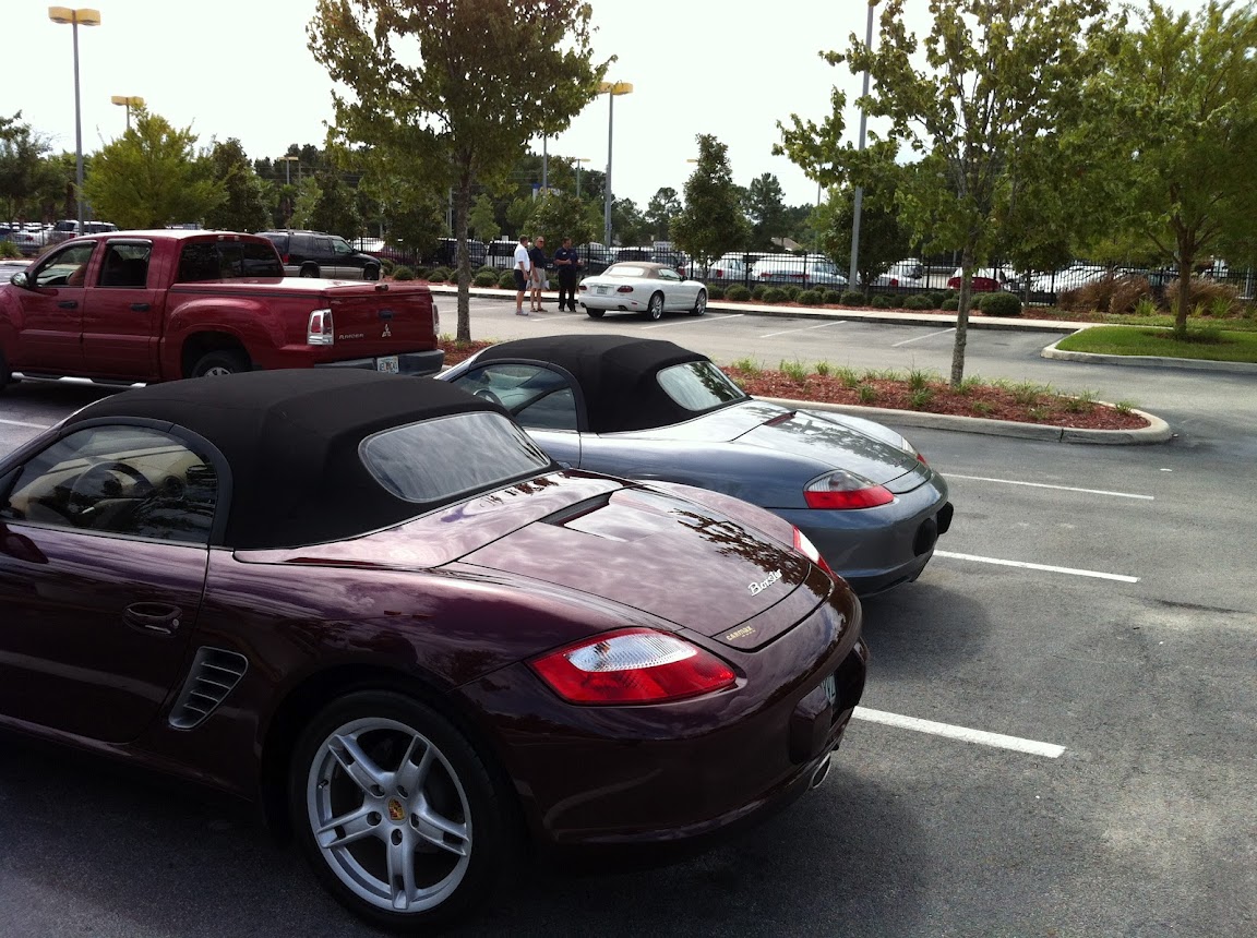

That looks like a 987 top to me...

Not sure where the part number would be, but here's a comparison of an '06 987 to an '04 986. The rear weatherseal/trim piece on the 986 top begins to turn towards the bottom of the car just after the joint, while the 987 piece goes back more before turning down.
I also think the roof pivot points (on the roof transmission) may be a little different but I'm not entirely certain. I do know that the way they attach to the transmission is different, though.
