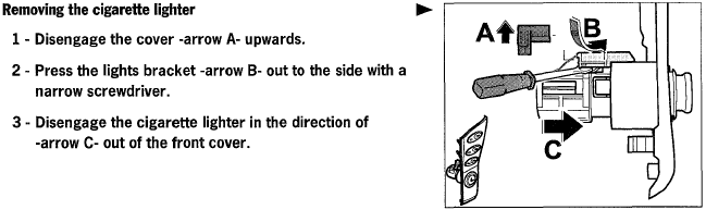

I just received my new Cigarette Socket/Lighter from Suncoast and after looking in my Bentley Service Manual I can't seem to find how to remove the old socket. Any thoughts?

Try using the forum search function. I'm quite sure this has been covered a few times.

Thanks JFP...replacement was easy.
