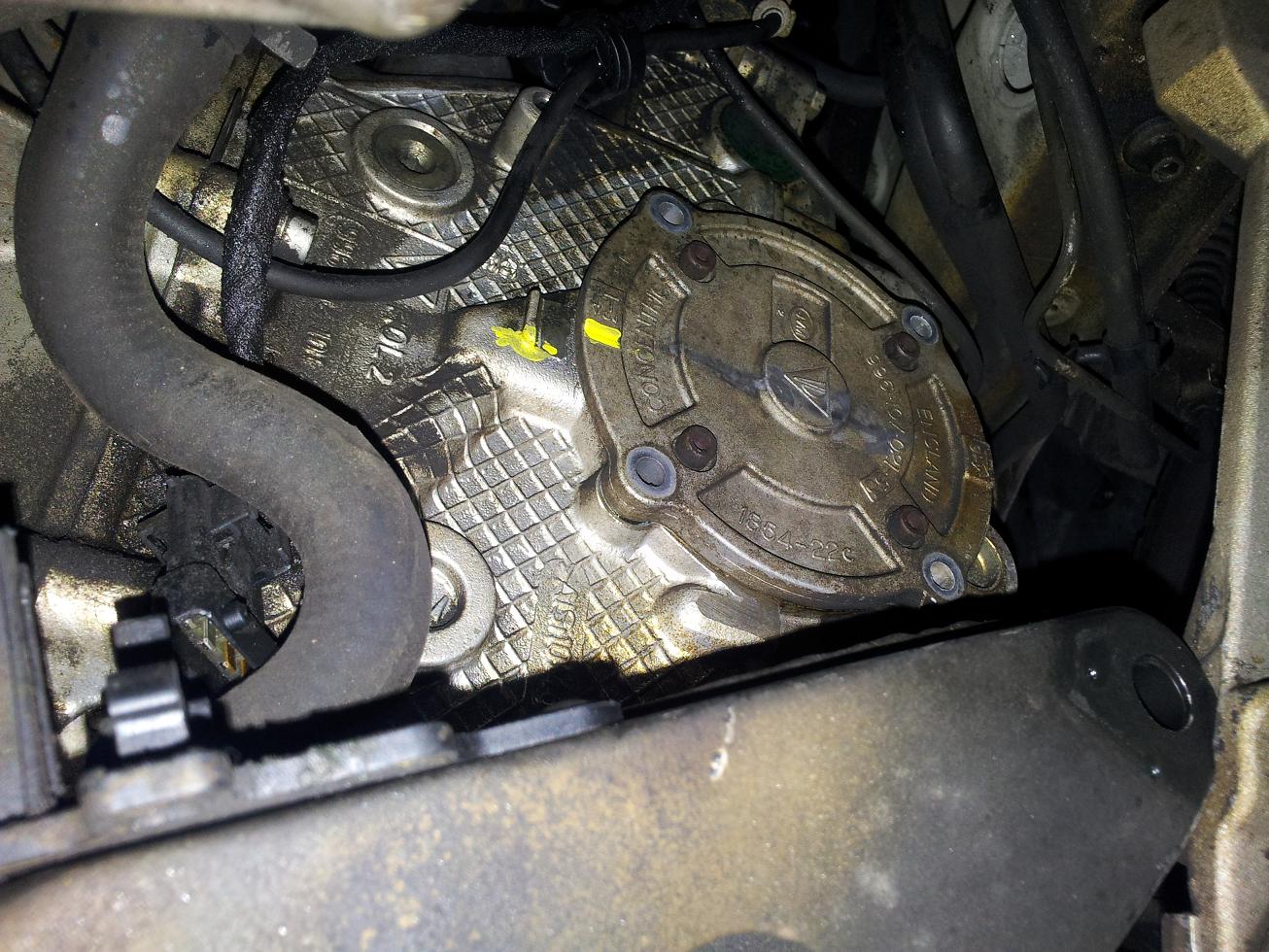

healthservices 09-21-2012 05:30 PM
OK there is no way this can be right. I drain over a gallon of oil out of the valve cover!
Attachment 16572
Is there a port from the oil pan to the timing cover area?:confused:
Sent from my SAMSUNG-SGH-I717 using Tapatalk 2
healthservices 09-21-2012 09:45 PM
Counter clockwise looking from the transmission end....An observation - if the cambox is (over) full of oil, yes could you have a faulty (or inefficient) oil pump on that particular side ?? You say the pump looked OK - how did you test it?But you probably thought of that already......
Actually the pump physically looks okay. But dunno. Normally unless this type has deep scores it is good.http://img.tapatalk.com/d/12/09/22/mugazudy.jpg
Could I have the wrong pump on there?
As in a front pump in the rear or two front pumps?
Steve Tinker 09-22-2012 01:02 AM
HS
As you probably know, there are 3 oil pumps, one in the crankcase and one in each cambox / valve cover.
If you drained a gallon (+/- 4 litres) of oil from ONE valve cover, that's nearly 50% of the total engine oil capacity.....
What does the oil level on your dipstick look like after everything has cooled and settled ? Low?
Looks to me like something ain't right with the oil scavenging pump or oil return path - where does the pump discharge to?
Perhaps one of our resident professionals can chime in on this....
Jake Raby 09-22-2012 04:18 AM
You could also have an obstruction inside te engine oil passages that return the scavenge oil from te cylinder head into the crankcase and then down to the swirl pots to be defoamed.
We see intake valve stem seals go bad that cause as much oil consumption and chamber contamination as anything else, which is something else to consider.
The pumps are also installed incorrectly in their bores or the body is disassembled and phased incorrectly into the housing. If these things happen it won't move any oil.

healthservices 09-24-2012 09:31 AM
3 Attachment(s)
Well this sucks. I really hope I changed the clocking of the pump in the housing by mistake when I inspected it. I spun the shaft clockwise (looking at the shaft) in oil and it blew out oil from the correct port. I blew air into the valve cover pickup port and no blockage. I pulled the pan and blew air into the output pressure port and air came out freely from the drivers swirl pot.

healthservices 09-24-2012 11:14 AM
http://986forum.com/forums/attachmen...oil-pumpon.jpg
This picture almost looks like there is an arrow drawn the other direction in black marker. :confused:
healthservices 09-24-2012 11:20 AM
Could the pump just have a low output causing it not to keep up with the oil buildup? Or maybe a oil passage port plug has come loose,or not not installed correctly?
