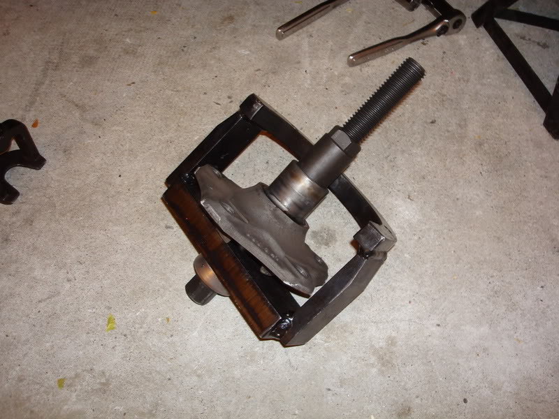

So I started doing the bearing today.... I bought the bearing removal tool but half way through I realized it did not have the hub extractor like the one below
I have one question.....How do you get the axle out from behind? They kind of glance over it in the tech article
magnusk9 is offline   Reply With Quote

If you are doing the rear you need the hub extractor. I was able to do the front without though it took me a couple days of trial and improvisation.
If you need the hub extractor let me know.
As for removing the axle, I removed the 6 bolts that connect it to the tranny, loosened the axle nut (wheel) until it was flush with the outer end used a small piece of wood as buffer and tapped softly with a rubber mallet. Watch the axle as it will probably be resting on the exhaust and it's heavy.

I use a universal hub puller like this one:
Walmart.com: OTC 7394 Universal Hub Puller: Tools
I didn't pay NEARLY that much for the puller. I think it was about $60. I've used it on several different vehicles.
I use the "puller" to push on the drive shaft until it pops out. Then back it out and put a socket between the end of the axle and the shaft of the "puller". Tighten back up and the the hub pops free.
