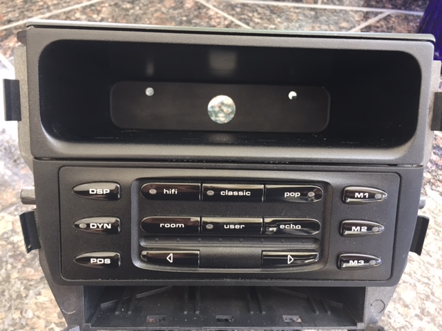

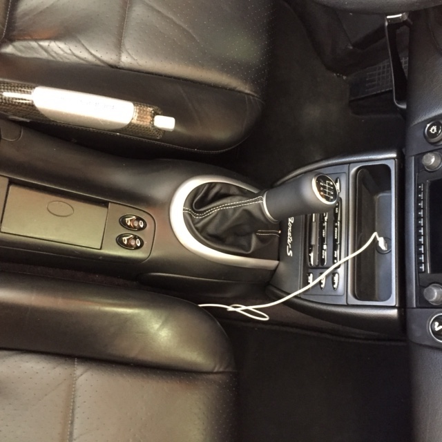

hahnster 05-02-2015 03:49 PM
CDR-220 USB Port for AUX
I just installed the USB-BKR in my auxiliary port of the CDR-220. I decided to go with the USB option so I could have more flexibility in what I plugged into the unit. I thought I would share some pictures. I was trying to go for a factory look yet still keeping the cord accessible. I ended up drilling a whole in the center console. It turns out there is already an indentation in the shelf that you can drill out and presto it's centered nicely. I am very pleased with the look and the functionality. The audio sounds great, it charges my phone and the navigation audio from my phone also plays through the speakers. Could not be happier.
http://986forum.com/forums/uploads01...1430610377.jpg
:dance:http://986forum.com/forums/uploads01...1430610471.jpg
BruceH 05-03-2015 09:17 AM
That looks great! Nice job:cheers:
