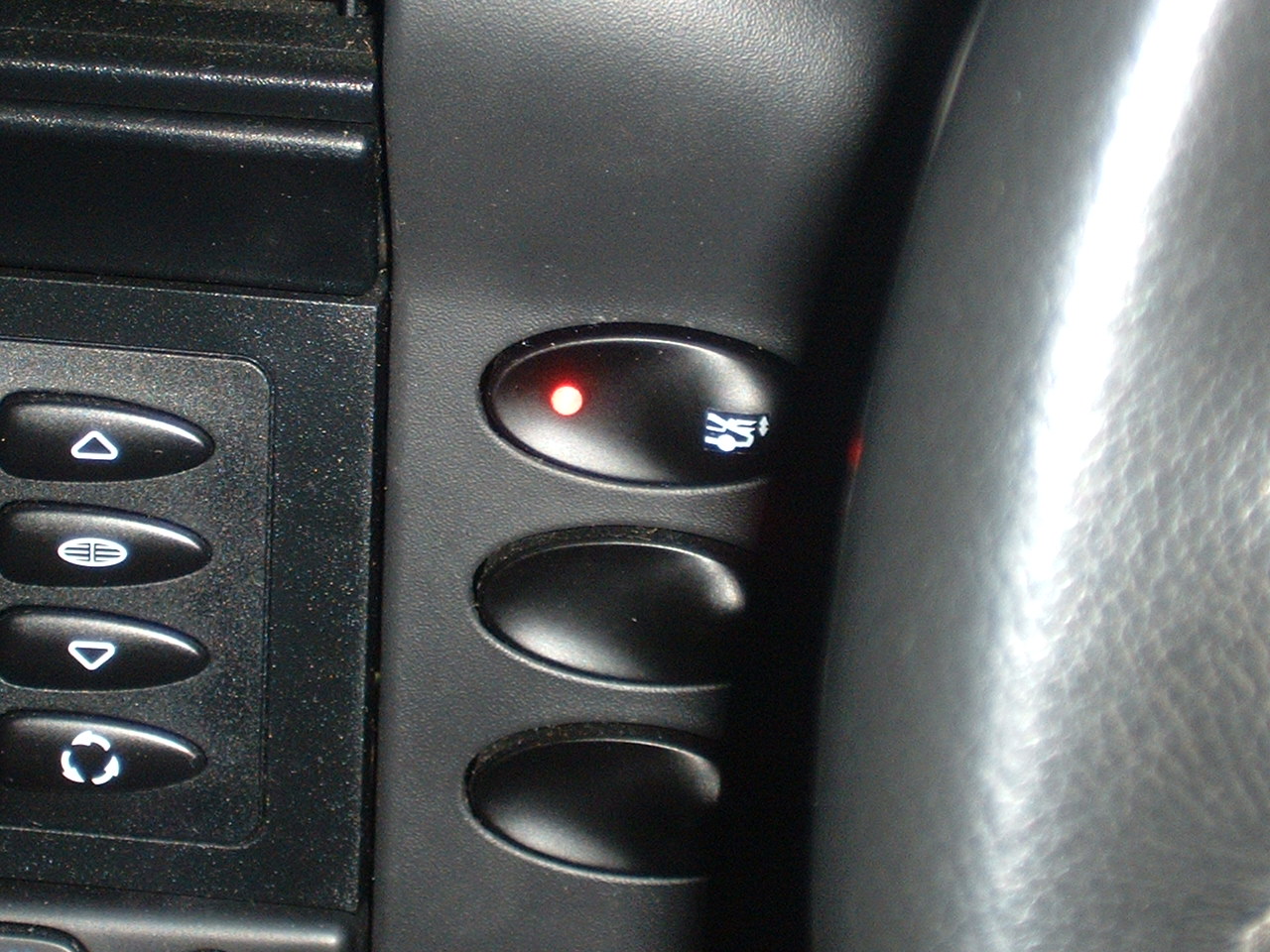

Guvs 02-01-2012 04:33 PM
I have a dash board switch that lets me know when it's going up flashing Red LED at 75 MPH (in my Boxster) solid Red LED
when up, and it will only come down (flashing Red LED) when doing 50 MPH, unless I press my other retracting button at 60 MPH
Attachment 15968
although I think the spoiler on the Boxster is fantastic looking bit of kit , it does get a bit embarrassing if after you have put
your foot down to say join a motorway from a slip road and the spoiler comes up, you then slow down to 60MPH and your
spoiler is still stuck up in the "go faster mode" until your speed comes down to 50MPH when it will retract automatically,
you get what we call over here in the UK "Boy racers" seeing this (Spoiler up) as an invitation to a race against them in their
Vauxhall corsa's, so that is why I've put this button in to retract it at 60 MPH one touch manually works a treat.
Guvs.
http://986forum.com/forums/uploads01...1328142754.jpg
BYprodriver 02-01-2012 04:37 PM
I know that's the correct up & down speeds but is that switch oem option?
Guvs 02-01-2012 04:46 PM
The one with the picture of a spoiler on it I got off eBay, the other one I mad up myself.
wvboxst3r 02-01-2012 05:49 PM
How did you wire this up? Just guessing you extended the wires from footwell?
Guvs 02-01-2012 06:11 PM
The top one is wired up behind the dashboard to the red spoiler warning light block connector, all the instructions came with the switch, the other one is as you say a direct wire from the foot-well switch, but only on the down motion of the switch.
