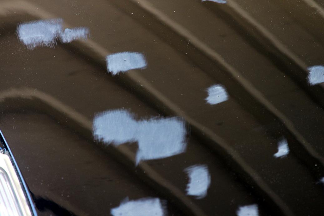

Sorry I don't think I have any pics of the chips before the fill.

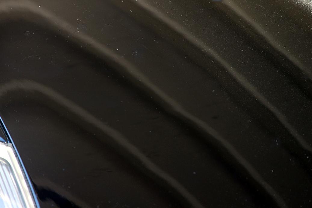

couple more after a buff
That last photo looks pretty decent, is that the finished result? I think I could live with that.
