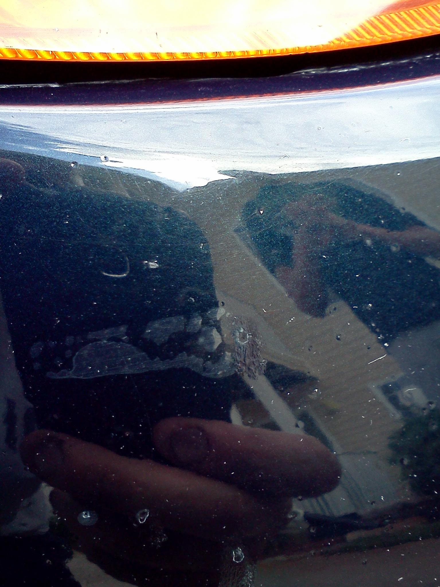

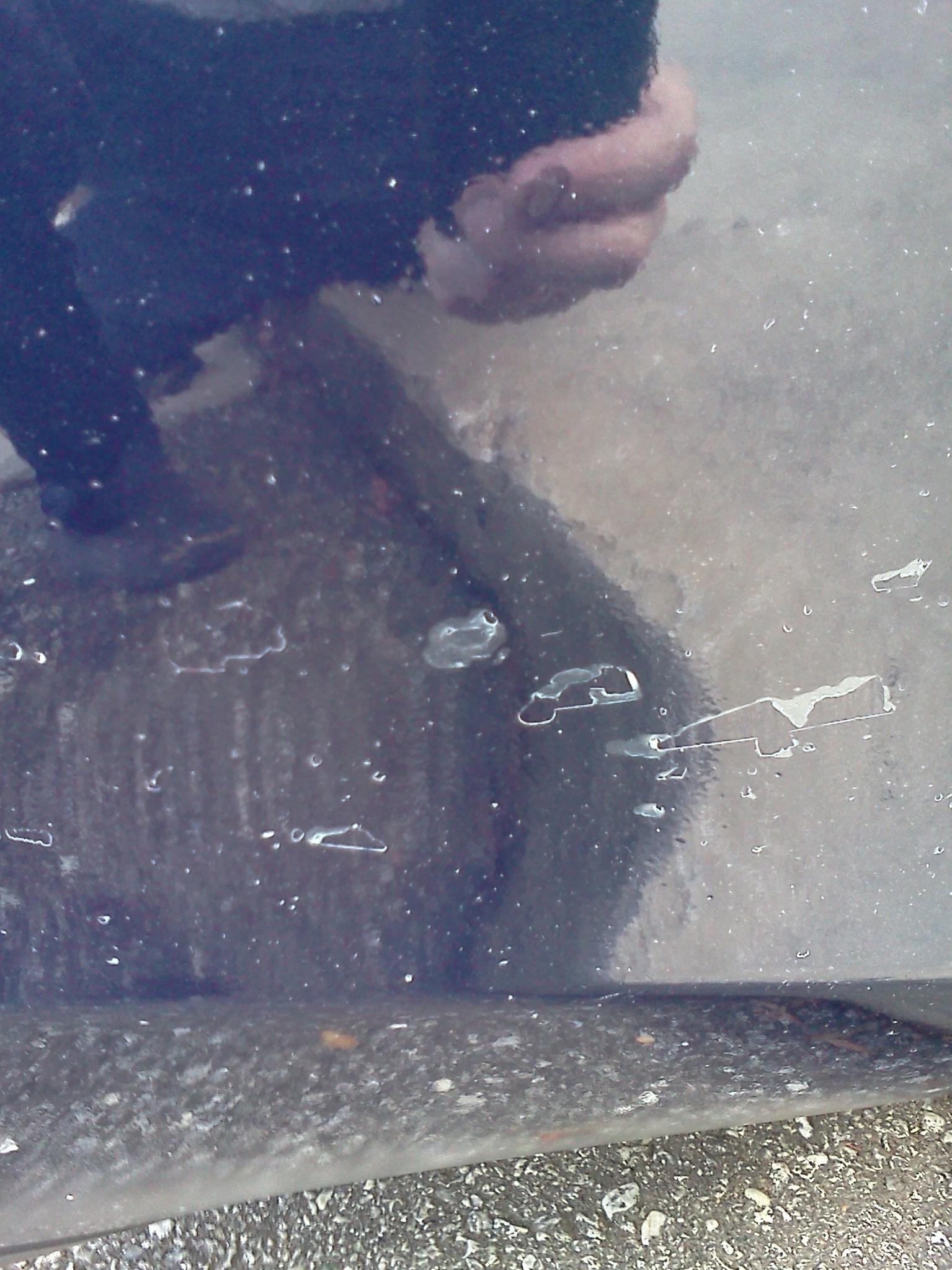

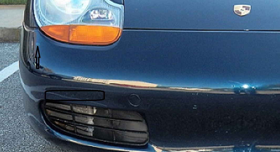

Better pics
http://986forum.com/forums/attachments/boxster-general-discussions/15642d1321270334-front-bumper-finish-help-img_20111113_131621.jpg
http://986forum.com/forums/attachments/boxster-general-discussions/15643d1321270334-front-bumper-finish-help-img_20111113_131638.jpg
http://986forum.com/forums/attachments/boxster-general-discussions/15644d1321270334-front-bumper-finish-help-img_20111113_132031.jpg

ok, now I'm with you. Definitely looks like a respray which wasn't cured properly... basically a quick masking effort - especially if bought through a dealer. You're best bet would be to take it to a quality body shop and have it resprayed (and cured) properly. Should be $600 or so.
