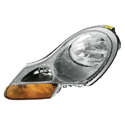

look at your lights.
there are two "styles" - one where the front plastic is orange and one where the front plastic is clear and the orange is inside the light.
you can perform an amberectomy on the second style. the second style simply has an orange coating on the reflective portion of the light that can be heated and pulled from the light housing.
if the plastic front portion of the turn signals are orange, these can not be deambered.
these can be deambered:
these can not:

Thanks - didn't think I'd be so lucky. I have the un-deamber-able kind
