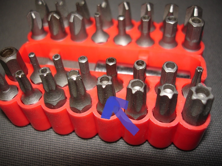

Yes you can clean the MAF sensor, you will need a tamper resistant Torx bit (T-10) see picture below.
