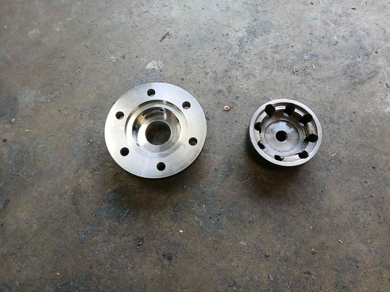

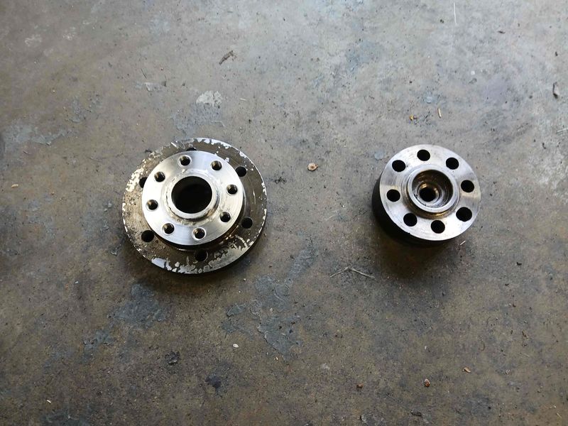

I decided to upgrade my flywheel adaptor.
The old one just sandwiches in-between the Mazda CW and the Porsche flywheel. It works, but the "new model" is in a whole different league.
I turned out the new adaptor out of 1045 steel. I made it so the adaptor bolts directly to the CW and the flywheel bolts to the adaptor.
I should be able to dump the clutch at 10 000 RPMS now.
^^^^^ I turned down a bushing so I could drill the holes in the adaptor accurately
^^^^^^ this is the bushing.
^^^^^ I used the bushing to drill the adaptor.
Here's a time lapse I made that goes over making the adaptor out of a chunk of round stock.
