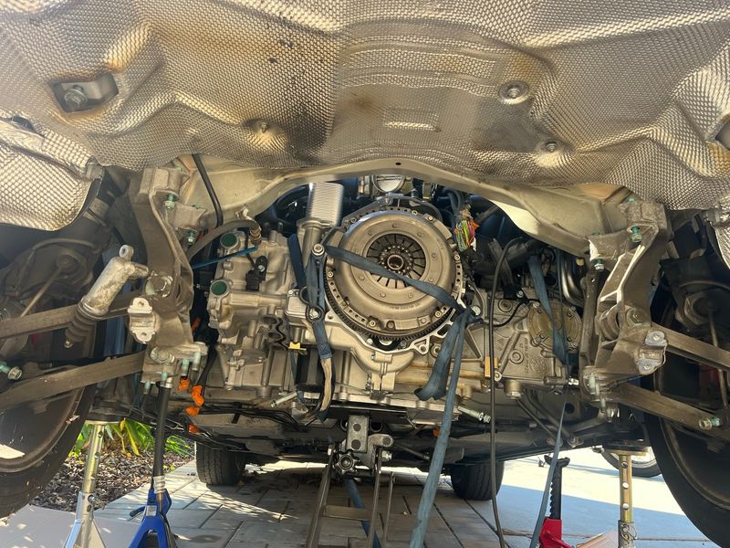

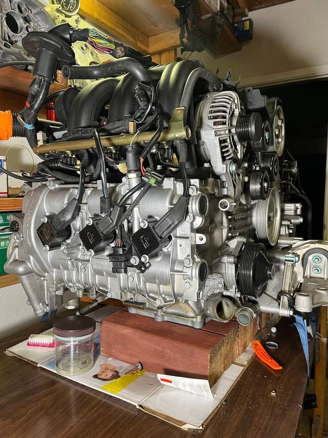

Homeoboxter 11-07-2025 11:39 PM

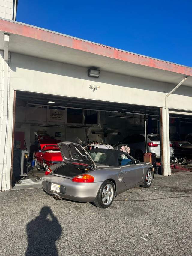

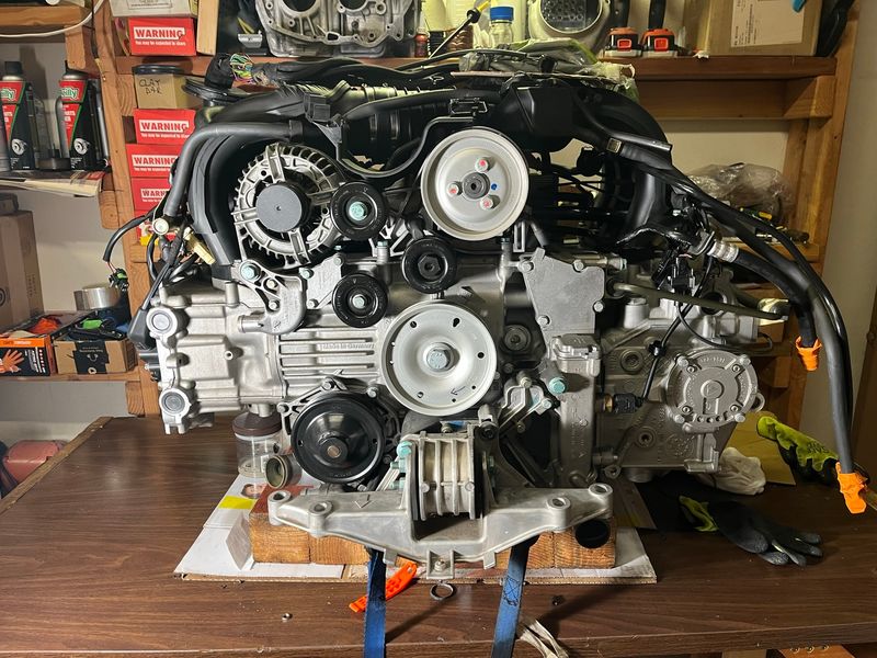

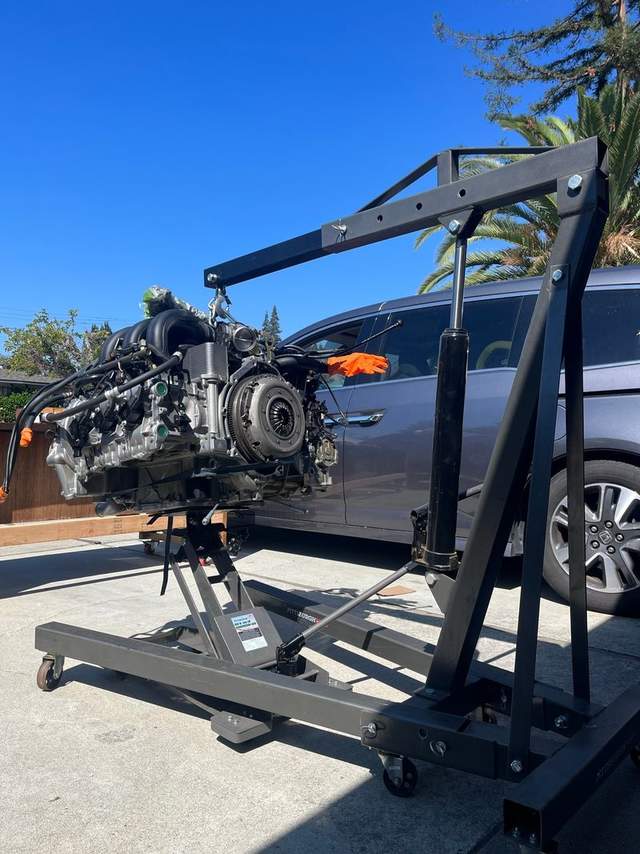

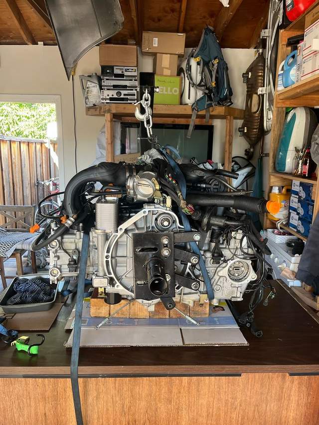

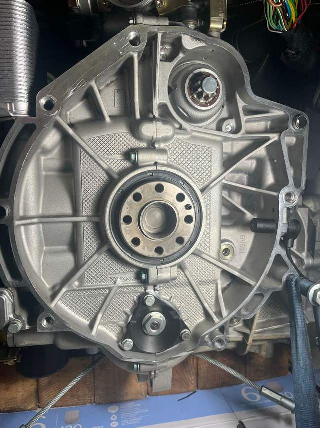

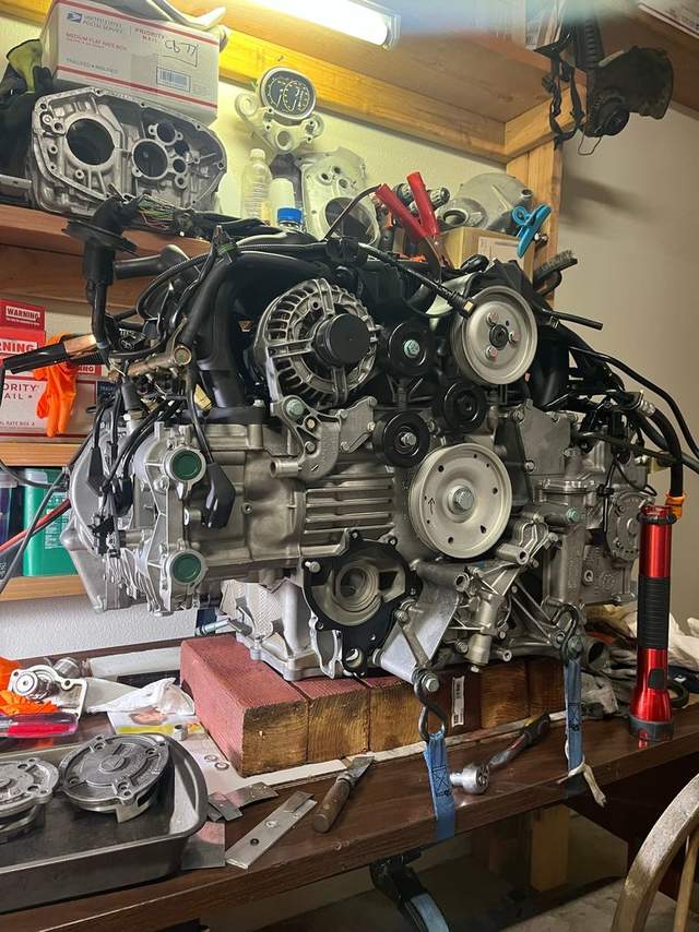

Finishing up.
http://986forum.com/forums/uploads02...1762586578.jpg
http://986forum.com/forums/uploads02...1762586631.jpg
http://986forum.com/forums/uploads02...1762586330.jpg
http://986forum.com/forums/uploads02...1762586357.jpg
http://986forum.com/forums/uploads02...1762586382.jpg

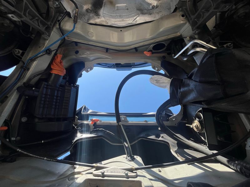

Great look onto the sky through the engine bay.
http://986forum.com/forums/uploads02...1762586401.jpg
http://986forum.com/forums/uploads02...1762587446.jpg
http://986forum.com/forums/uploads02...1762586431.jpg
Smog test. Passed!
http://986forum.com/forums/uploads02...1762586465.jpg
This is after 500 miles. So far so good.
http://986forum.com/forums/uploads02...1762586484.jpg
