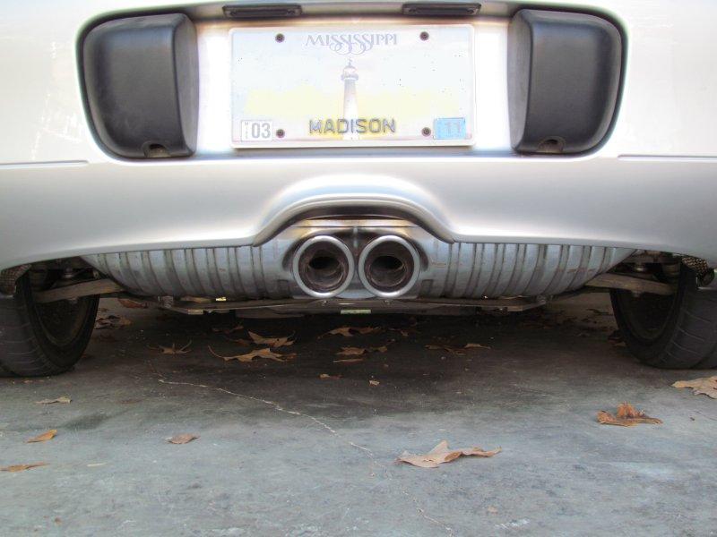

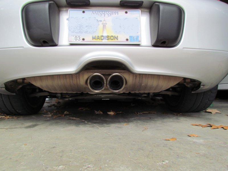

I decided to clean up the muffler a bit.
Before:
http://986forum.com/forums/attachmen...id=13847&stc=1
After:
http://986forum.com/forums/attachmen...chmentid=13848

Looks good! What did you use on the pipes?
tommy986 03-02-2011 04:57 PM
On the muffler and the tail pipes I used the same process.
Sanding with 320, 800, and 1000 grit sandpaper.
Followed by buffing using a rotary buffer with a wool pad and buffing compound.
