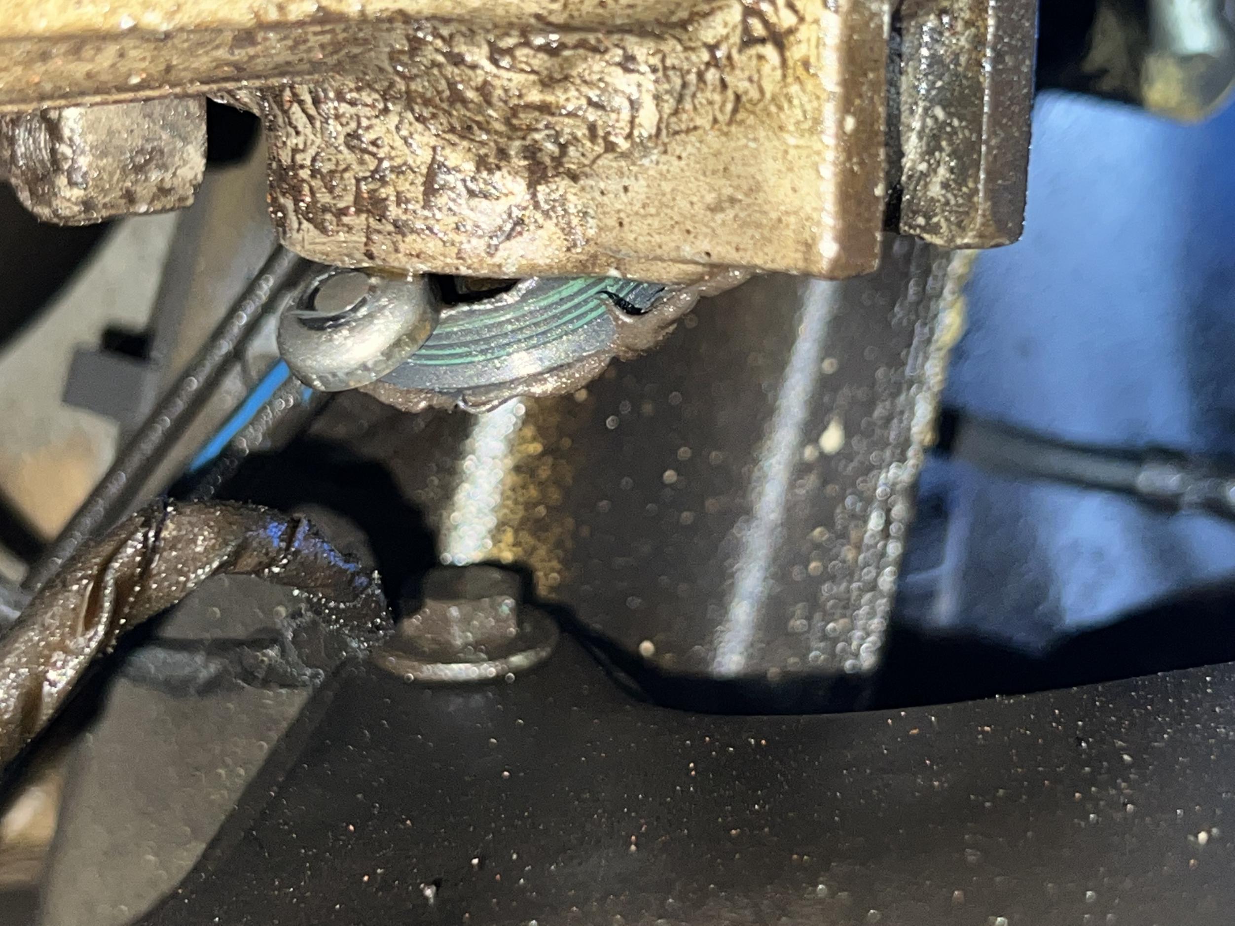

Lockholder 05-03-2023 07:56 PM
Got the car up on ramps and was able to find out where my leak is coming from. the green plug which i believe is a camshaft end plug, and the steel one looks like a expansion plug or freeze plug. question is how do i reinstall the expansion plug/freeze plug back into the cam?
Attachment 23498
JFP in PA 05-04-2023 05:50 AM
That looks like the freeze type plug from the end of the camshaft:
https://cimg1.ibsrv.net/gimg/rennlis...2d5daa3c6d.jpg
Lockholder 05-04-2023 05:58 AM
I believe so yes. Sorry it wouldn’t let me upload the steel plug and green one. But from what I could find is it’s a plug from the end of the camshaft and the green one is a drive in one. Now how hard is it to get new ones in?
JFP in PA 05-04-2023 06:08 AM
The green plug isn't your problem, they pop right in with finger pressure, the plug in the end of the cam however is a major issue. The correct way to replace them requires the cams out of the cylinder heads.
Lockholder 05-04-2023 06:12 AM
I saw the green plug was just pretty much a cover. There’s no way to get the plug back in the cam with it still in the head? Also, do you by chance have a part number for the right plug? I keep getting a few different plugs and just want to make sure I order the correct one.
JFP in PA 05-04-2023 07:42 AM
We never use freeze plugs, we drill and tap the cams for a threaded insert with sealing Loctite on it that prevents this from ever happening again. Plus, I'm not sure the factory part is still available.................
