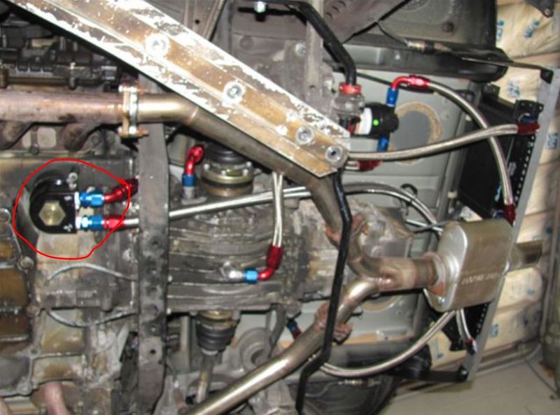

truegearhead 03-06-2019 03:58 PM
Originally Posted by JFP in PA (Post 590070)
Simple: Blow air thru each port, the one that flows to the center opening is the oil coming from the filter back into the engine.
Thanks JFP this will definitely work, I wish I han't connected it all together yet. Before I disassemble it and go with this method I thought I'd see if I can get lucky one more time. Here is an image (that I shamelessly stole from the internet) of the sandwich plate I'm trying to determine which port is out and which is in.
:cheers:
http://986forum.com/forums/uploads02...1551920277.jpg
steved0x 03-06-2019 05:28 PM
Is it this canton sandwich plate?
https://www.cantonracingproducts.com/canton-22-546-aluminum-oil-cooler-adapter-univ-sandwich-style-13-16-16-2-5-8/
If so the diagram on the linked pdf should help you.
