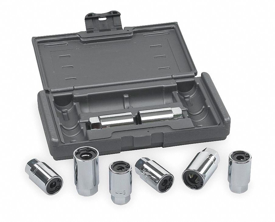

This should work:
https://www.grainger.com/product/2HLG9?gclid=CLWzgIaDstMCFR2ewAod8aoDiA&cm_mmc=PPC: GOOGLEPLAA-_-Fleet%20and%20Vehicle%20Maintenance-_-Automotive%20Mechanical-_-2HLG9&AL!2966!3!166591513365!!!s!61865531738!&s_kw cid=AL!2966!3!166591513365!!!s!61865531738!&ef_id= WPghvAAABfuS8GpB:20170420024932:s
https://static.grainger.com/rp/s/is/..._AS01?$zmmain$
