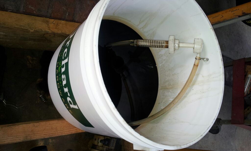

healthservices 04-30-2014 09:36 AM
This was the quote from back then...
Originally Posted by healthservices (Post 306907)
OK there is no way this can be right. I drain over a gallon of oil out of the valve cover!
Attachment 16572
Is there a port from the oil pan to the timing cover area?:confused:
Sent from my SAMSUNG-SGH-I717 using Tapatalk 2
