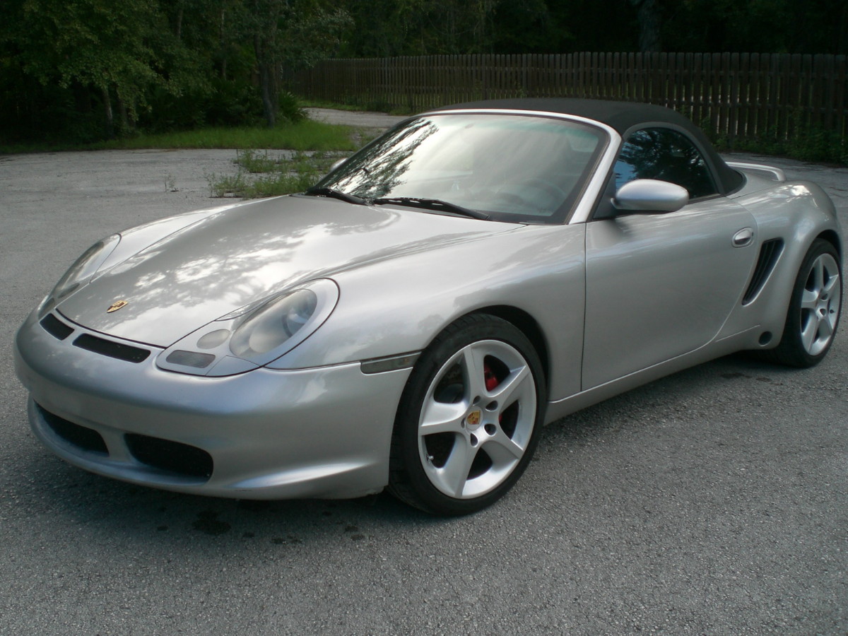

2 Attachment(s)
QUOTE=Johnny Danger]Are you sure that you are running an 11 inch wheel on the rear ? Throughout all of my experience with wheel applications, using an 11 inch wheel on a 986 boxster seemed impossible .[/QUOTE]
YES I'm sure. beside it being stamped in the wheel I measured it. Like I said I had to flare the fenders in order to avoid rubbing the tires during DE but I ran them on the street for a while without flares. stuck out about an inch.

Harry, your car is sitting quite high in the before pic...have you lowered since installing the flares? I know you track it, so I assume it was raised just to fit the wheels initially. I've always remarked you can fit almost any size wheel/tire combo if the spacers are correct and the car is ready for the Dakar Rally.

harryrcb 01-06-2011 07:20 PM
I believe the before pic was stock suspension, no lift. I later installed the ROW MO30 and it corners just fine. I do well at the track and surely could do better with full on race suspension but then I would loose my street car. Not in the budget for a second Porsche rightnow. lol
