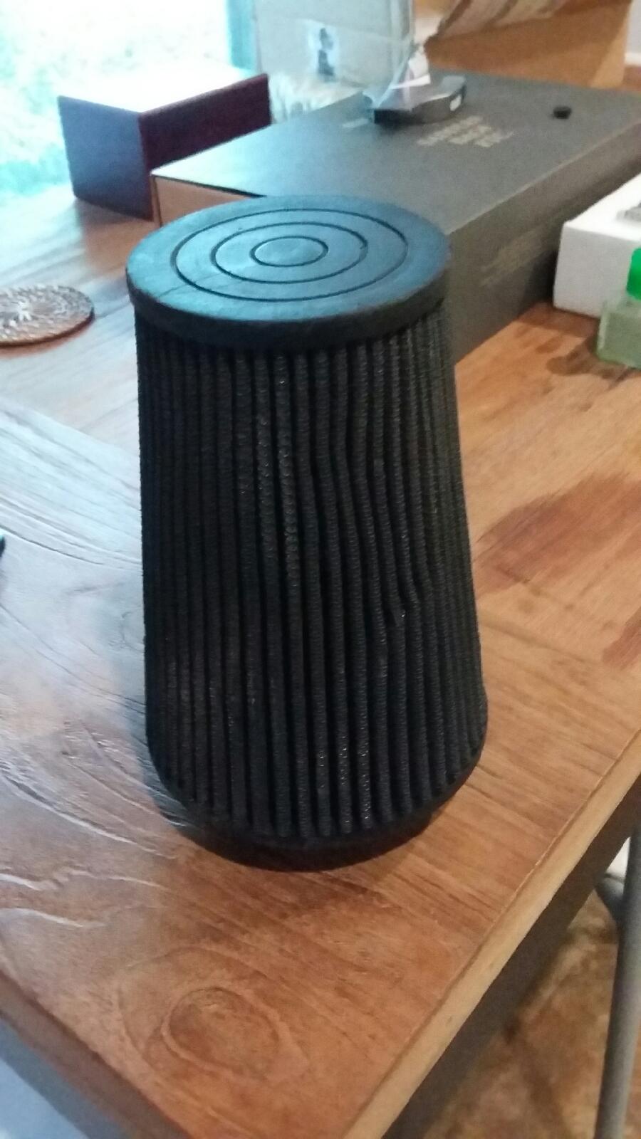

gnomish 07-27-2015 09:09 PM
Hopefully this filter is not too far gone that these suggestions won't help. Finding another filter with the same dimensions has been futile so far.

Go here for another filter cone Porsche 986 High Flow Intake System EVOMS and call them to just order the filter. I bought a second filter several years ago so I could clean, oil and let one sit so the excess oil drains off and won't clog the MAF. If you go on uTube and do a search for cleaning reusable oiled filters you'll find several videos that will show you how. The filters really need to be washed out with slight pressurized water from the inside out, let dry and then re oil. There are also several videos on uTube to show you the correct way to oil and not over oil.:cheers:
sickbananas 07-28-2015 06:44 AM
Your filter is not gone, it just needs a wash. I have the same filter and wash it often. I clean mine in a bucket using washing powder (hand washing powder) where I let it soak and rinse it under the tap visourouly, I sometimes repeat the process if it is really dirty. After I'm done cleaning, I blow it dry with a blower or compressor. I then let it bake in the sun for a while until it is dry and if there is no sun I use a hair drier before I spray on the filter oil I get from the auto parts store.
I find this process very effective.
gnomish 07-28-2015 06:17 PM
Well glad to hear I have options. Would K&N air filter oil work well for this?
sickbananas 07-29-2015 02:06 AM
Any air filter oil spray will be fine. With the K&N you are just paying for the name, they are all the same and do the same job IMO.
edc 07-29-2015 02:07 AM
Any cotton filter oil should do. They just come in different colours. I normally loosen off any larger bits with a Hoover and by banging the filter on the sink then just clean in the shower with washing up liquid and the pressure from the shower head with an old toothbrush.
Luv2Box 07-29-2015 06:08 AM
However you clean it clean it from the inside out. You want to push debris to the surface and off and not into the filter, unless you are using a vacuum cleaner.
gnomish 07-30-2015 07:56 PM
My local auto parts store only had the K&N products so that is what I got. Starting cleaning my Boxster's filter when I realized I also have a reusable filter in the GTI so did that one too.
Filters definitely looks cleaner and the water in my bucket is pretty murky. Directions for re-oiling instruct to spray until the filter is uniformly red on both sides.
