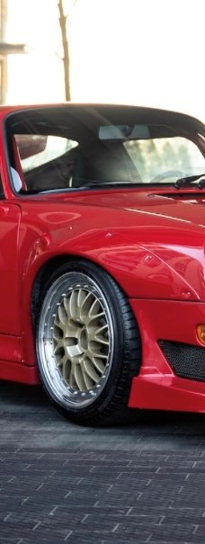

People have been doing great things with the boxster and these two were my inspiration to try something i have never done before.
http://986forum.com/forums/uploads02...1694791154.jpg
http://986forum.com/forums/uploads02...1694791171.jpg
I have zero automotive training or skill. Just want to see what i could do. It is almost time to for primer so thought i would share the progress thus far.

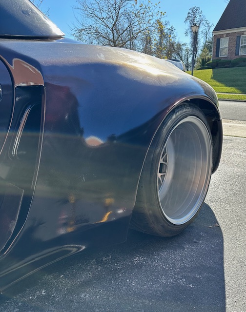

I will Be the first to admit, my measurements were completely off. I understand now why you should have your wheels in the sizes you want to build out to instead of widening the car and trying to make wheels fit. Rebuilding 3 piece wheels however turned out to be easier than I thought it would be. Next summer I am going to have to go back and change quite a few things but right now I am happy with the direction. Hoping to have it in a drivable state before I hack it up again, lol.

Thanks, but the fitment is where it is. I made the fender wider than I wanted in the rear. My own fault, I didn’t have the wheels when I was doing them so it was kind of a guess. To anyone wanting to widen the front you can use a metric 8 rod coupler to put on the stud and push the radiator bracket outward. Gave me the clearance I needed. Now I have to figure out fender liner modifications to fit because I don’t think I want to drive without them. I think this week I am going to put it all together and see the finished work before tackling the liners.

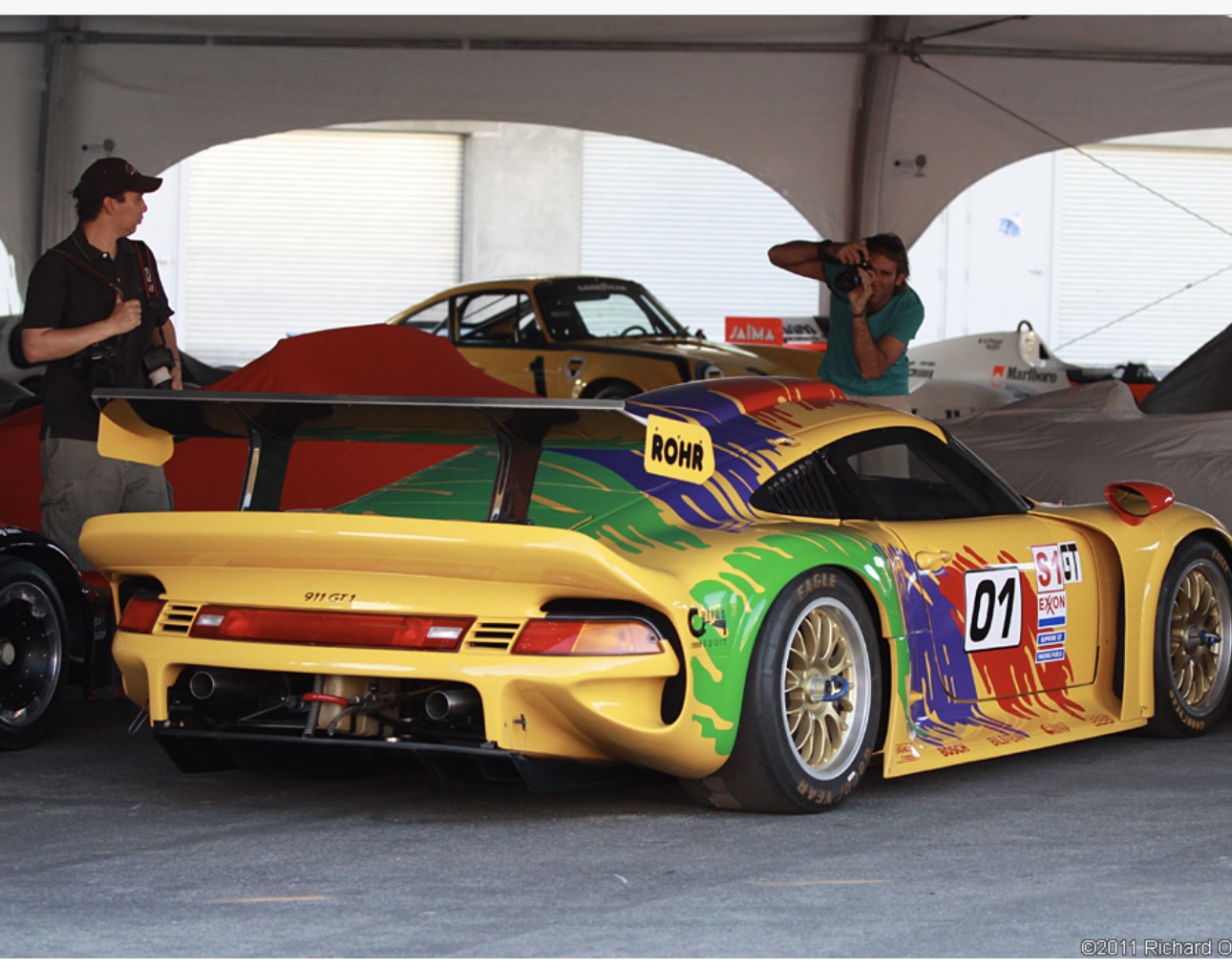

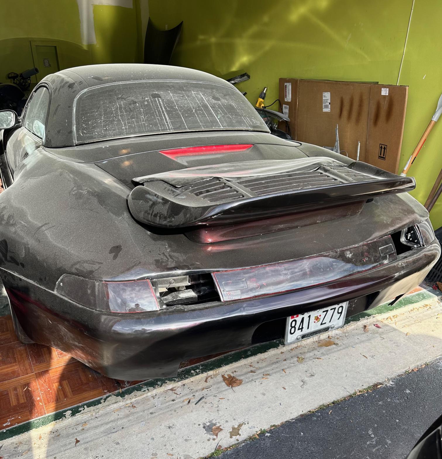

Question if anyone wants to give input. My rear end is as good as I can get right now. I will likely redo it next summer but wondering what I should do with the gaps between taillights. I thought about doing this
Attachment 23549
But I don’t have the skill to create that. So I am thinking mesh to fill the empty spots or maybe just leave it empty. Thoughts? My car
Attachment 23550
