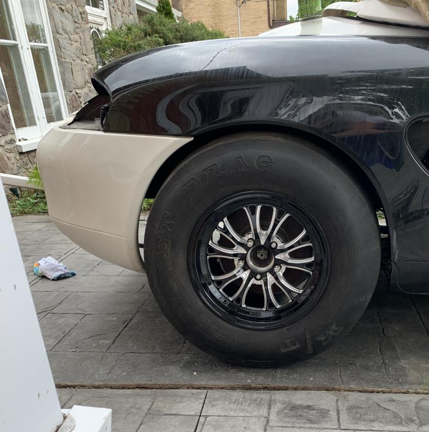

Wheels and Tires
Weld Magnum 10x15 28/10.5 MT ET
Jeggs Spike 10x15 28/10.5 MT ET
Summit 8x15 255/60/15 (tow wheels)
Weld Magnum 4x15 28/4.5 MT ET
Summit 4x15 (tow wheels)
Wheels and Tires Images
