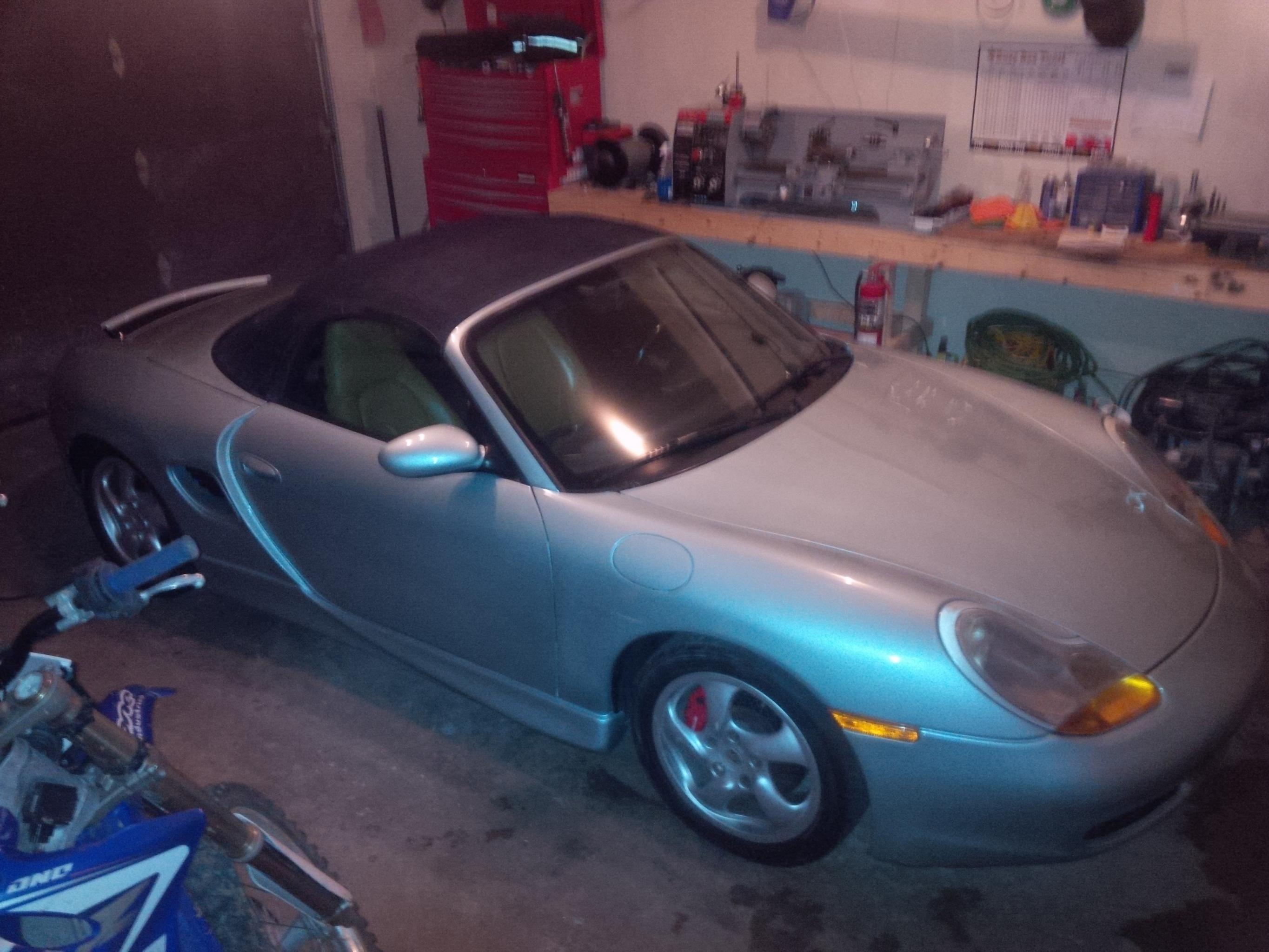

Here is the car

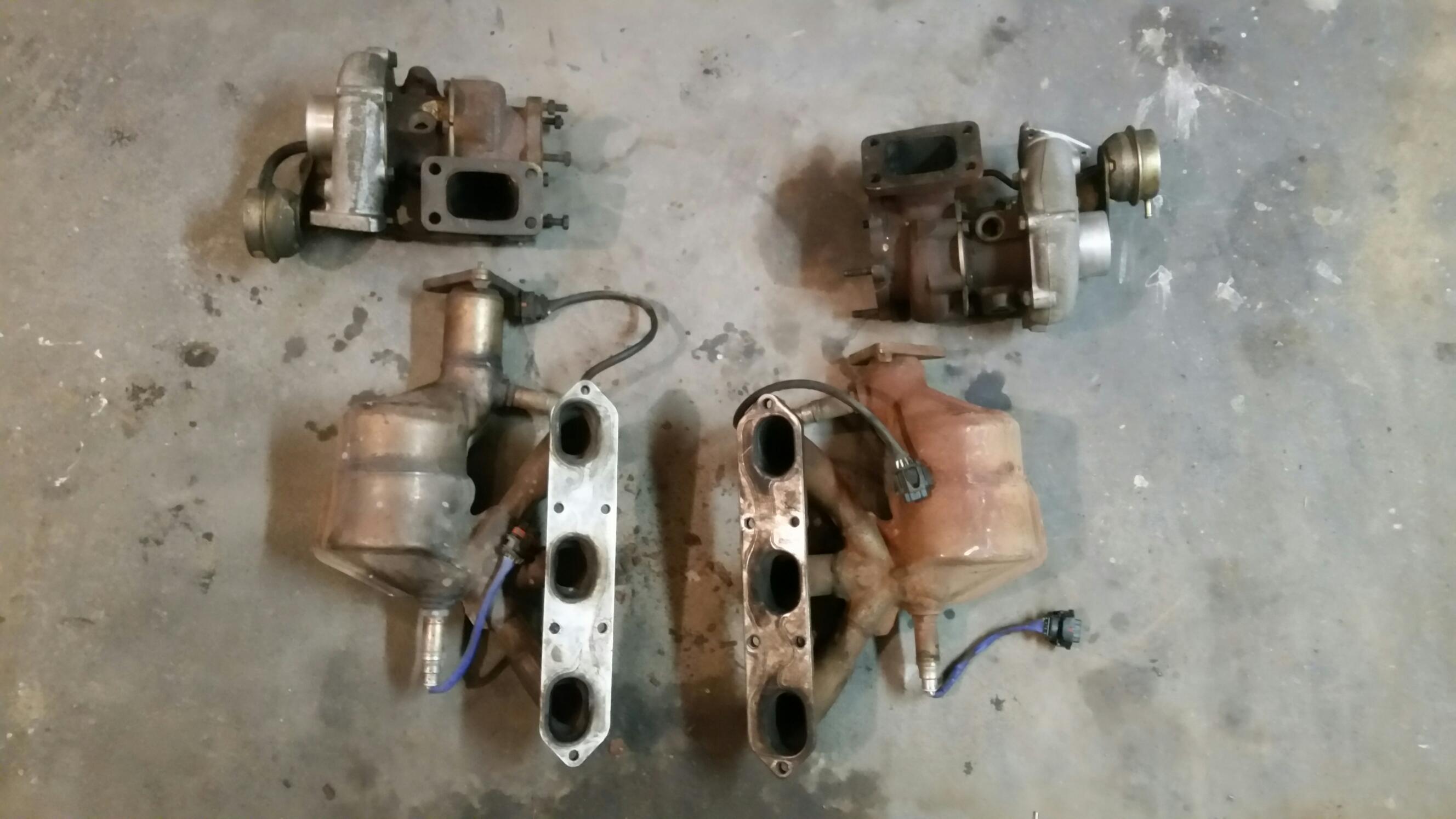

Here is the hint....Porsche Purists look away, you are not going to like this one :ah:
Attachment 21771
Anker 12-09-2018 03:27 PM
Looks like two of the world's smallest turbos!

deathsled986 02-18-2019 10:35 AM
Does this car just have the rear TA style widebody over fenders installed as opposed to the entire kit? Or are those a different brand/style? Hows the fitment of those rear fenders?
Jgkram 02-18-2019 11:42 AM
I think you just found it...;)
986piper 02-18-2019 02:26 PM
The widening of the rear I actually did by cutting the quarter panel skins and bringing them outward about 1-1/2". All welded w/ steel and approx. 2 million tack welds, lol. The skits are from an old fiberglass kit that I bought on craigslist, the were badly damaged and molded them up to the body and secured with 3M panel adhesive.

986piper 03-06-2019 05:06 PM
Yep, they are t28 Hybrids, this is not a 7liter Cummins. lol.
