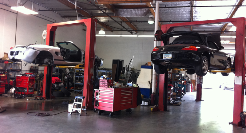

I dropped by Hergesheimer Motorsports today to see Eric523 and check on the build. Here are some pic's;
The wrecked silver car (left) is mostly stripped with the engine/trans/rear suspension sitting on the ground beneath it. The black Boxster (right) will have its blown engine/trans/susp removed and the parts from the silver car installed.
http://986forum.com/forums/attachmen...1&d=1499384513

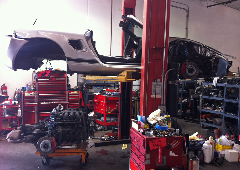

The right front fender has already been re-deployed to another Spec racecar that had some damage.
http://986forum.com/forums/attachmen...1&d=1499384103
Here is what it looks like underneath the fender with the front suspension still intact.

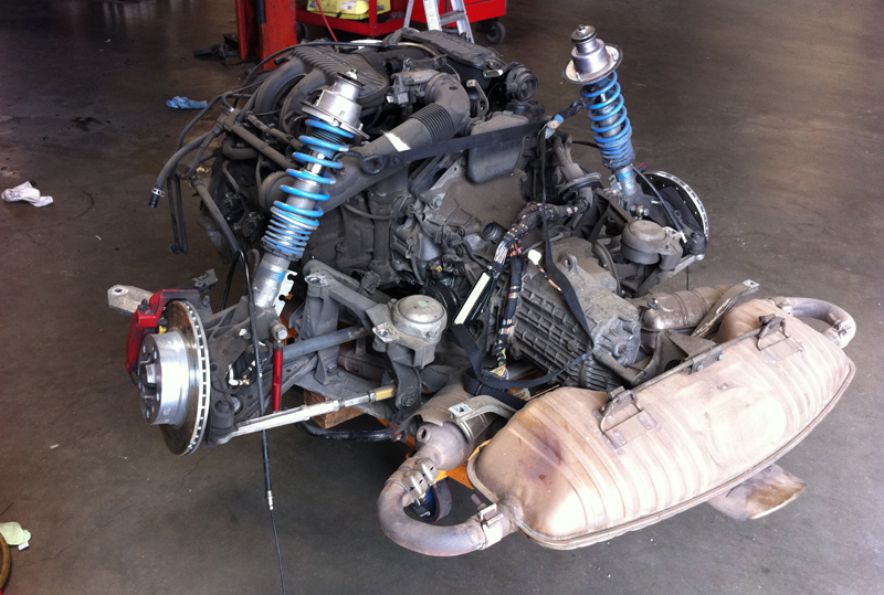

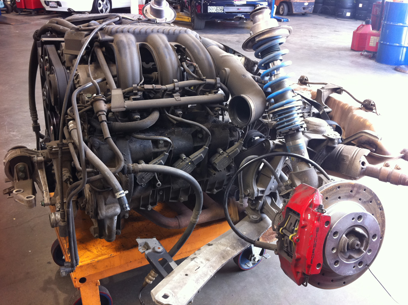

The entire engine/trans/drive shafts/hubs/brakes/rear suspension ready to be swapped to the donor car.
Nice shot of the rear PSS9, Tarett drop link and toe link, wheel carrier, and brake caliper.
